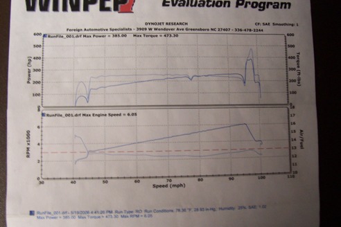

Old May 20, 2006 | 12:01 PM
silvr002001's Avatar
Posts: 33
heres the graph

Thanks for stating the obvious. Look at the graph. the HP peaks after the rpms drop off

After seeing the graph everyone please place thier penises back in thier pants. He's not even making 300rwhp.
