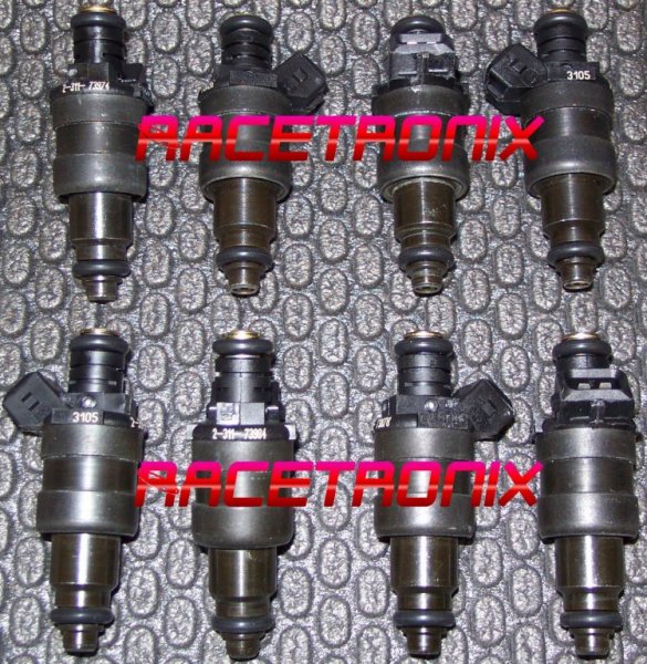

I just purchased a new set of 32lb injecotrs for my LT1. They are Racetronix 32lbs. Problem is when I installed them they just feel a bit loose compared to OEM. I just don't want to have gas spraying all over detailed engine.
The top of new injectors have 2 grooves cut into them The orig had only 1. The GM retainer clip only fits into the upper groove on the new ones. When installed the injector just feels loose. The OEM's had thicker lower body that fit snug into the manifold.
Is this normal??? Can I have the wrong injectors? Bought from sponsor in PA.

they should be fine. Use whatever groove the clip will fully go on to. I dont know why some recommend no using the clips and then just jambing the injector as far as it will go into the fuel rail. I like the clips. Besides if you dont use clips, I remember someone on here that didnt use clips and when he was testing his injectors for leaks, one popped off and got fuel all over him.
For piece of mind, mine and many others SVO injectors fit loose. I used the top groove with the clip and once in the manifold they have been fine for a while.

These are probably the Siemens DEKA 1 32's which should be just fine as long as the o-rings did not get nicked upon insertion.

When I was installing 30# SVOs, I noticed the stock O-rings were a bit thicker so I switched the them, gave me a snug fit.

I had #37/#38 Racetronix and they fit very snuggly, also remember when the motor heats up its going to close the tolerances. Also with the fuel rail it keeps down the injectors. I havent ran clips since the stockers were in. I wouldnt worry bout it.
