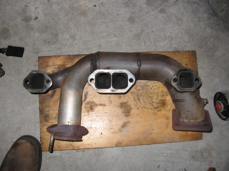

turbos are cool but they require a ton of fabrication. looks like you have got it all to work nicely good luck. how much has the build run you so far.

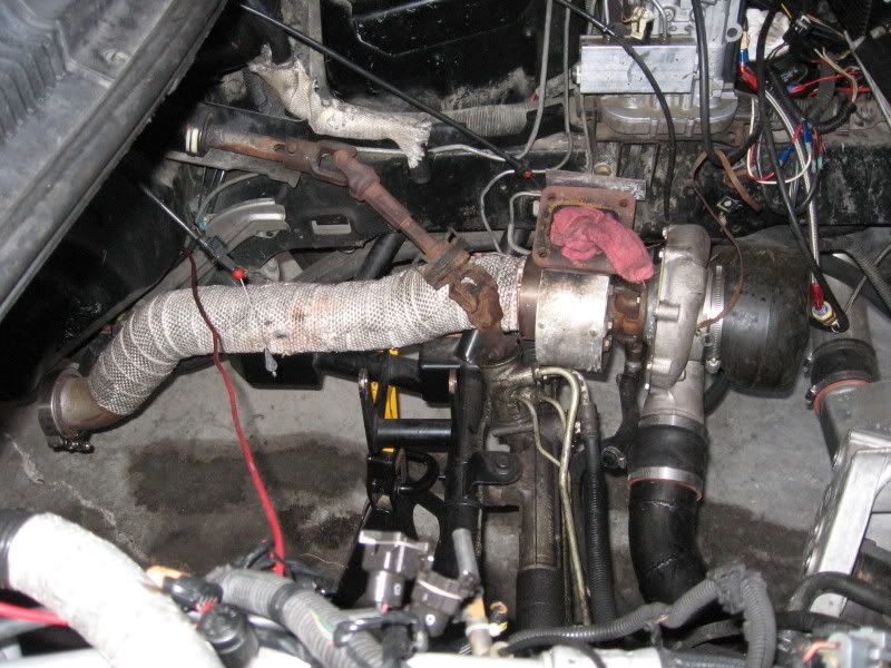

2 words, steering shaft?
These kits require the steering shaft delete kit...
I kid. It will fit. Small flat spot may be required when installing it.

looks good so far. i just dont see how the log style headers flow anything out of the 3 that has to 90* flow out of them. Why not just buy the chevy c10 truck headers and flip um? Iv seen um done a few times and it looks mint and not much fab work at all. But i do give ya some credit for doin it all yourself. Congrats eaither way.
Any pics of them on an lt1 4th gen? Or were they all done on other cars?

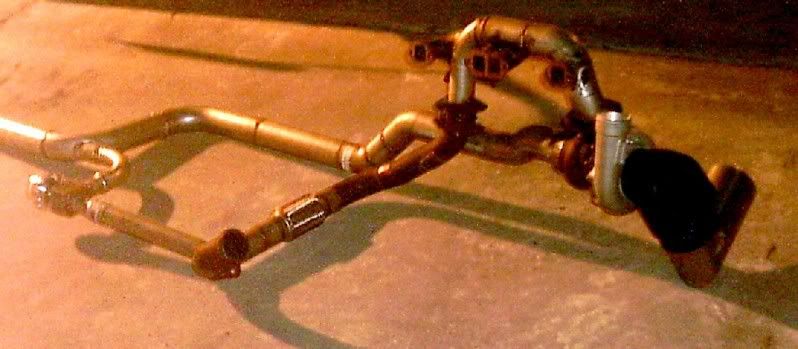

It will make power fine. Here is some pics of engineermike's setup which has a log manifold where three ports enter at 90 degrees.

From: MA
Two more pics showing turbo and layout of pass. side manifol (clears AC).

From: Catlettsburg, Ky
your setup looks very simple, and effective. the only thing that looks questionable at all to me, is the #2 cyl. primary going in to the log, but I'm sure it works just fine.
