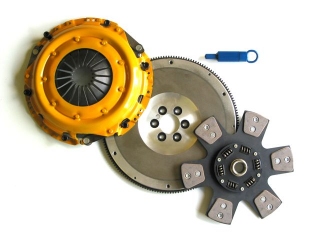

I ordered my Clutch Kit, it's the Textralia OZ700 Z-Grip, rated for 700+hp. I ordered it from WS6 Store, got some free ARP Flywheel Bolts too, they are good guys to work with.
I also managed to find an LS1 T56 as well. It's got 15,700 miles on it according to the guy I bought it from, I paid $1300 shipped for it. It came with a Bell Housing on it, so I sold that to a guy that needed one for $120, so the T56 only cost me $1180.
That's the last of my parts, I'm happy..
