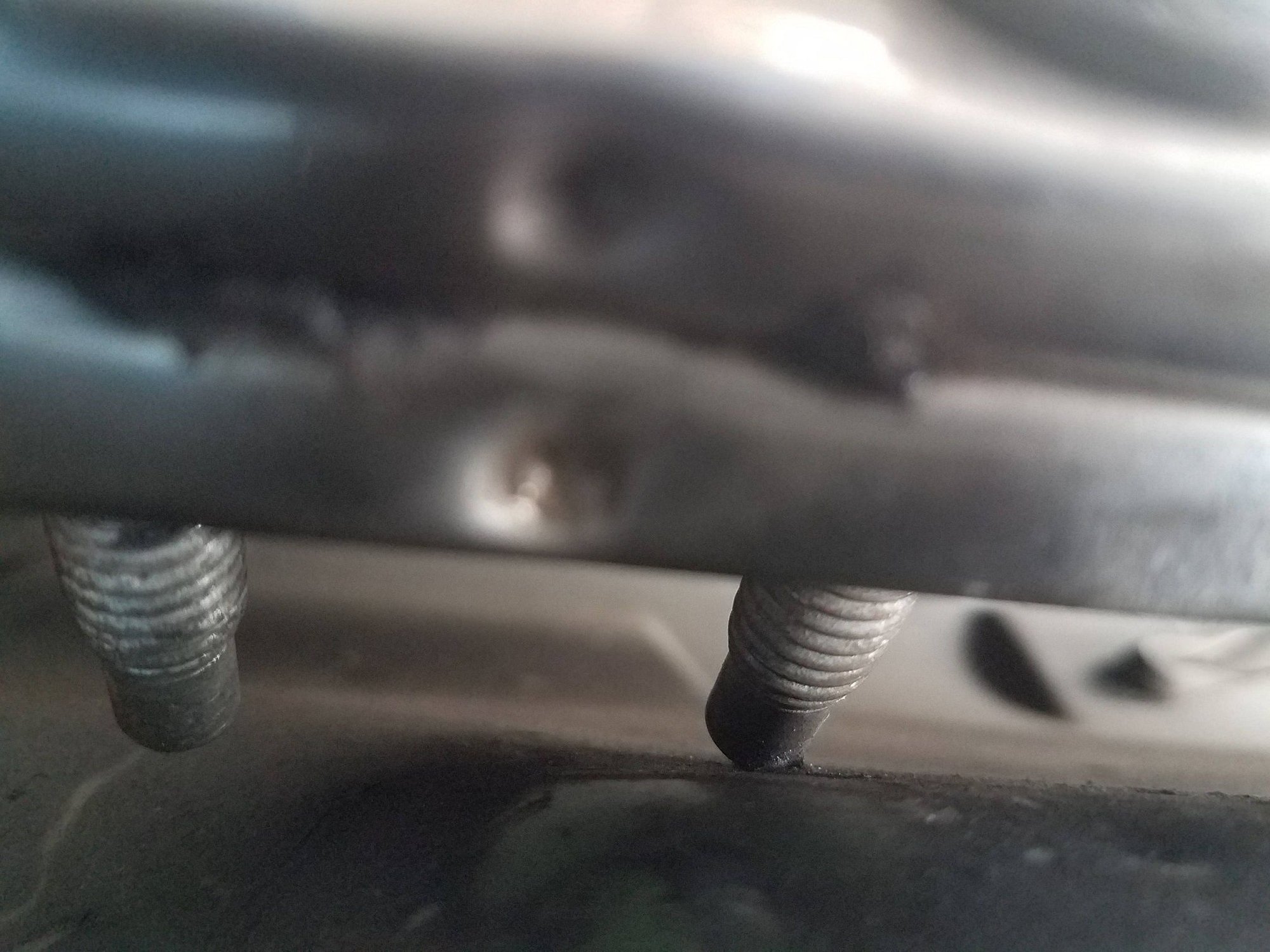

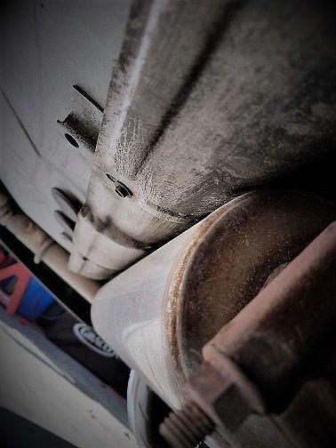

This is not moving at 2k rev Clutch in clutch out, no change. The engine and the shifter are steady as a rock but you can feel it in the body, almost like I have solid mounts on the motor and trans (I have poly motor mounts, poly TA, and poly trans mount). I moved around the exhaust and it got better, tomorrow I'm going to lower it completely and see. My vbands are leaking so I need to reseat them anyways and take it for another test run.
The muffler is REALLY close to the floorboard back there now so something moved.

I'm an idiot. I had the band clamp at the end of the Y pipe at the wrong angle and when I tightened I didnt notice the bolt went into the body.....
