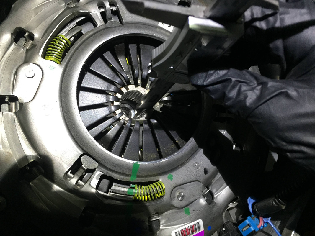

If you manually press down on the release bearing, can it fully retract right til the plastic bit bottoms out ?
Have you measured all heights to ensure this is ok for whatever clutch/BH etc you are using ?
Just in case some random problem has occured
Yes, I can bottom it out by hand.
It's tick's LS7 clutch package with the standard steel flywheel. I followed their directions and removed the spring from the slave, bottomed it out and did my measurements using a flat piece of 1" thick steel i had.
Subtracting the width of the straight edge I got 2.18" from the top of the PP fingers to the face of the bell housing, and 1.97" from the slave surface to the trans mount surface, giving me .21"
Tick's spec is 0.125 to 0.200. Should I add a shim to shave that .21" in to spec?

Absolutely no need to add shims.
Just measure to ensure the slave could never be too tall and preventing easy installation.

So, the input shaft has to be in the pilot bearing if the case is that close to the bellhousing and alignment is't his issue.
Old Apr 9, 2018 | 05:40 PM
pdxmotorhead's Avatar
Posts: 2,513
Likes: 480
From: PDX-OR-USA
Make sure there isn't a bunch of grease inside the crank behind the pilot, I had a guy "help" me once and did that,, it stops the input shaft like a rock.. If you crank it in by the bolts it can split the crank.. Hydro-lock on a tiny scale

That won't be an issue. I installed the engine, the pilot bearing and the clutch.

That crappy little plastic tool was dead on the nuts. The new tool slides all the way in to the pilot bearing, and there is no play in the quarter master tools. I checked the depth with a digital caliper. I even inked up the edges of the tool to see if it marked the pilot bearing, it did.
Bottom line, I'm getting frictional resistance and I'm not strong enough to push it home.

How about this. Remove you throw out bearing and if it slides all the way up you will know it's the spring holding it out. Then you can pull it back out. Reinstall the throw out and install it again.

I got it in tonight. I used the force.
