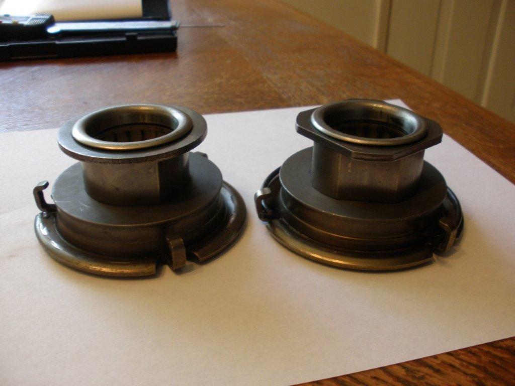

Square top on R
standard round top T.O. bearing
square top-thicker

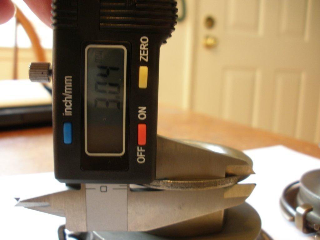

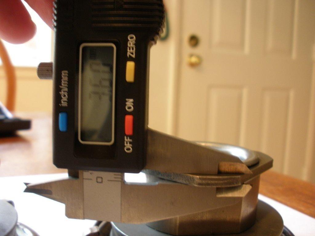

I have the McLeod Street Twin which is more than you need at your power level. But the PP would be the same as their single disc version you note. All clutch companies use the same clone LT4 PP. Just hub and disc construction are what they make. The typical T.O. bearing is...made in China.
I use the "square" top LT4 Vette TO bearing. It has a little bit more meat on the bones but also seems to be made off-shore. I re-used it from a old SPEC 2+ I ran when I had single disc clutches.
