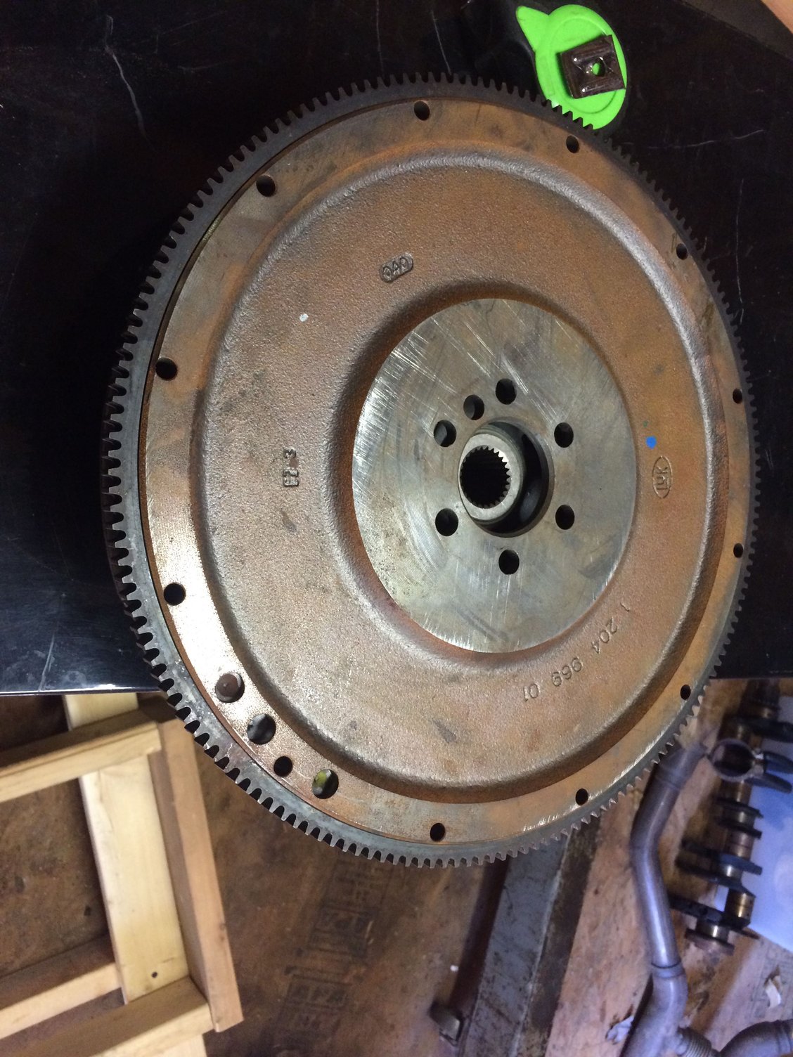

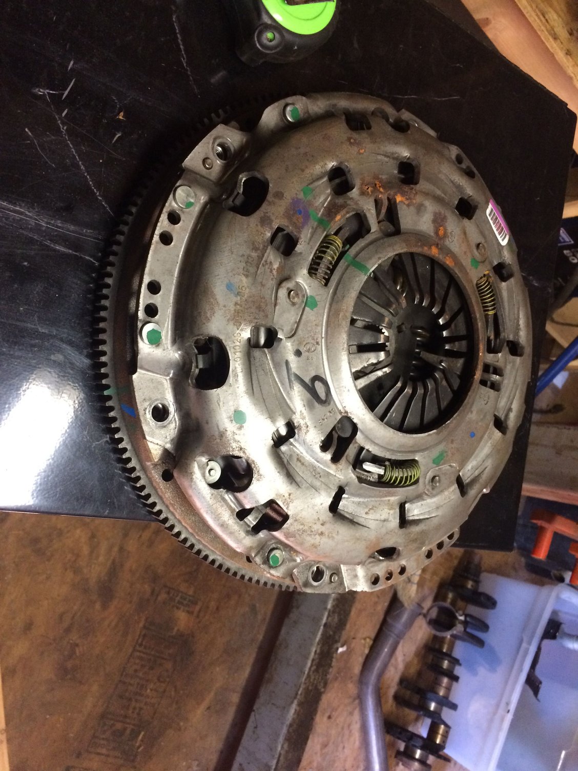

Originally Posted by Jdadams
The flywheel I got with it is a 6 bolt. So I知 good there. Thank you all for the input, definitely helped
Post pictures. You may not have what you think you have...The gen 2 CTSV had the LSA engine and it for sure used an 8 bolt flywheel.
Andrew
Old May 26, 2019 | 11:16 AM
Jdadams's Avatar
Joined: May 2019
Posts: 14
Andrew
Old May 26, 2019 | 11:18 AM
Project GatTagO's Avatar
Joined: Mar 2003
Posts: 10,617
Likes: 1,883
From: Little Austin
That looks like a LS 7 clutch and flywheel. Definitely not CTSV. Post pictures of the trans.

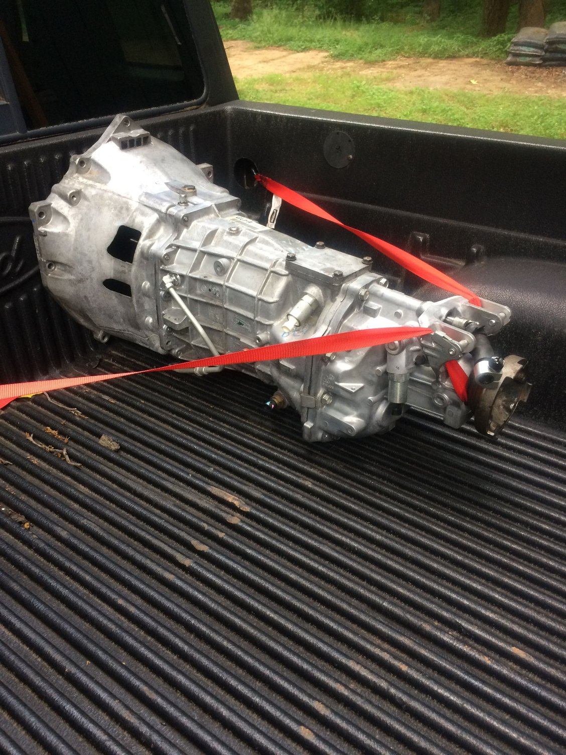

Old May 26, 2019 | 11:32 AM
Joined: Mar 2003
Posts: 10,617
Likes: 1,883
From: Little Austin
That's definitely a Gen 2 ctsv trans. But now your challenge will be which slave to use, because the clutch that you have is not as tall as the stock ctsv clutch. So you can't just use a ctsv slave. You'll need to mock things up and get an idea of how everything fits together. You also need to figure out how you're going to handle the trans output, since there is no slip yoke.
Old May 26, 2019 | 11:47 AM
Jdadams's Avatar
Joined: May 2019
Posts: 14
I will go with the ls3/ls7 slave to start with since that what clutch I have and get the ctsv pilot bearing. The ls3/ls7 Slave even looks alittle taller in the pics than the ctsv slave, so maybe that値l do it.
