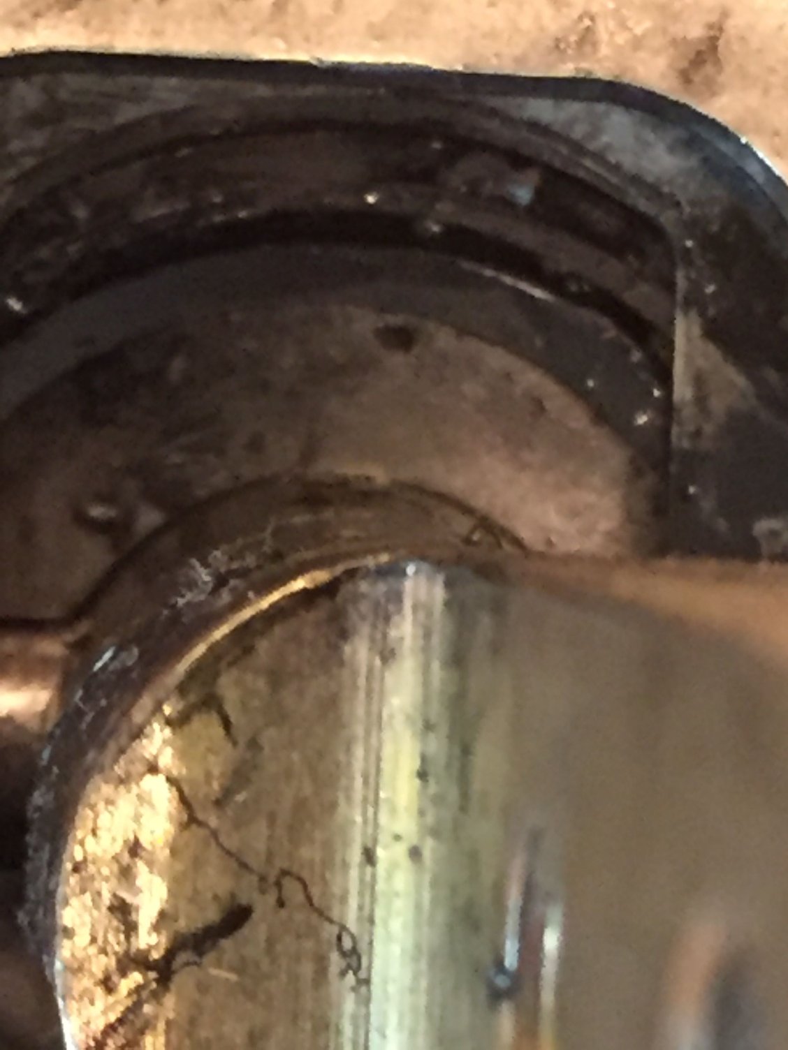

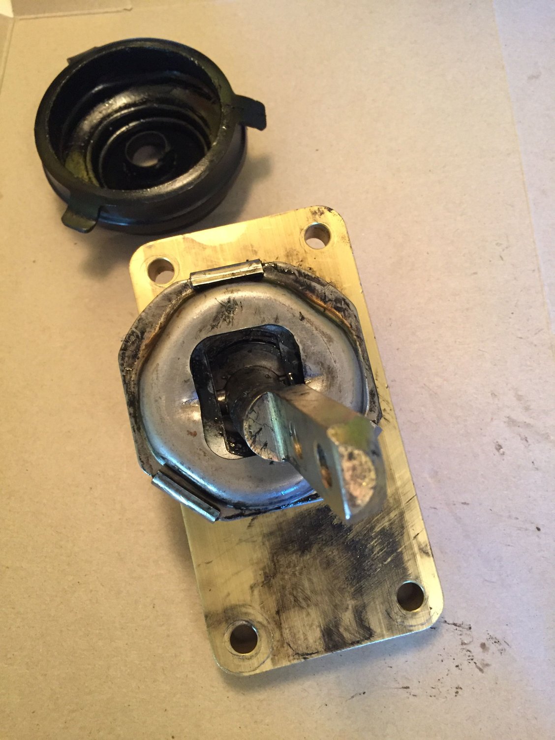

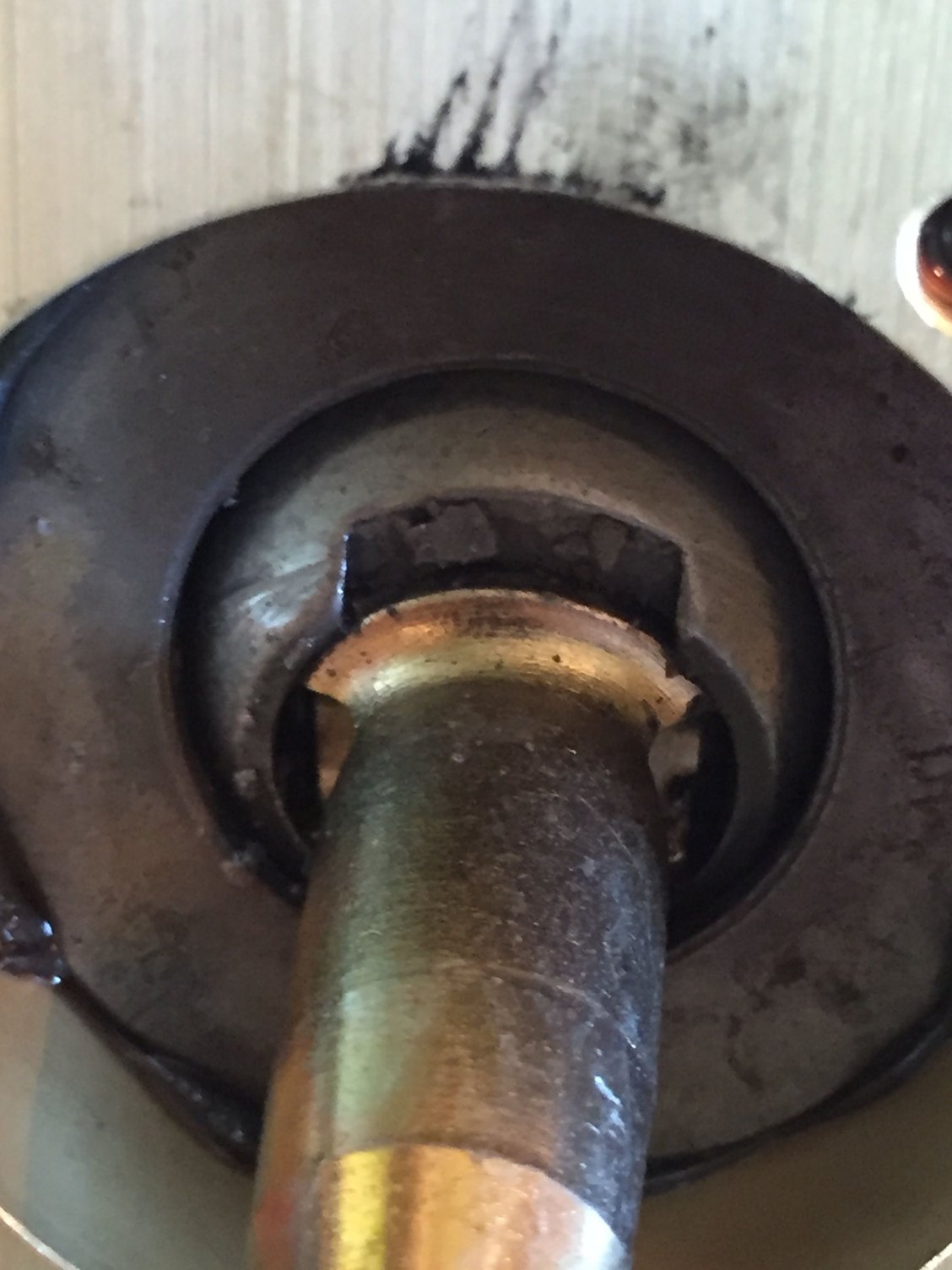

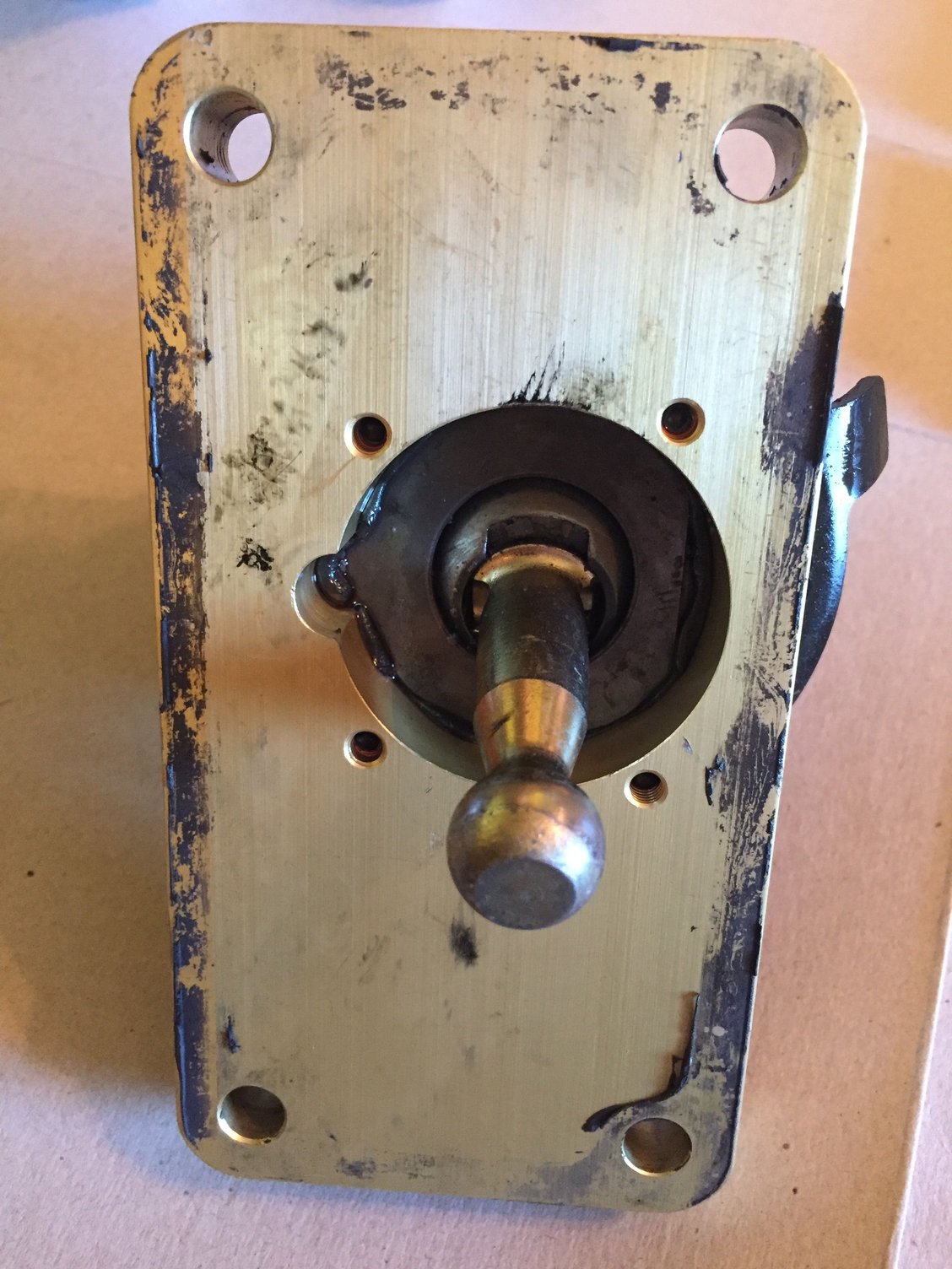

See the chunks coming out? This is out the bottom of the shifter and these could fall into the transmission which I’m sure can’t be good!
Top of shifter with rubber boot removed. No Allen head bolts to remove to get inside...
Close-ups of chunks visible from top of shifter.
Chunks removed already. They’re not magnetic, but not sure if they’re metal or hard plastic...
Another close-up from top with chunks visible...

Interesting. It looks like either dried up grease or an outer layer/coating of metal is coming off one of the wearing surfaces. Time for a new shifter, for sure.
