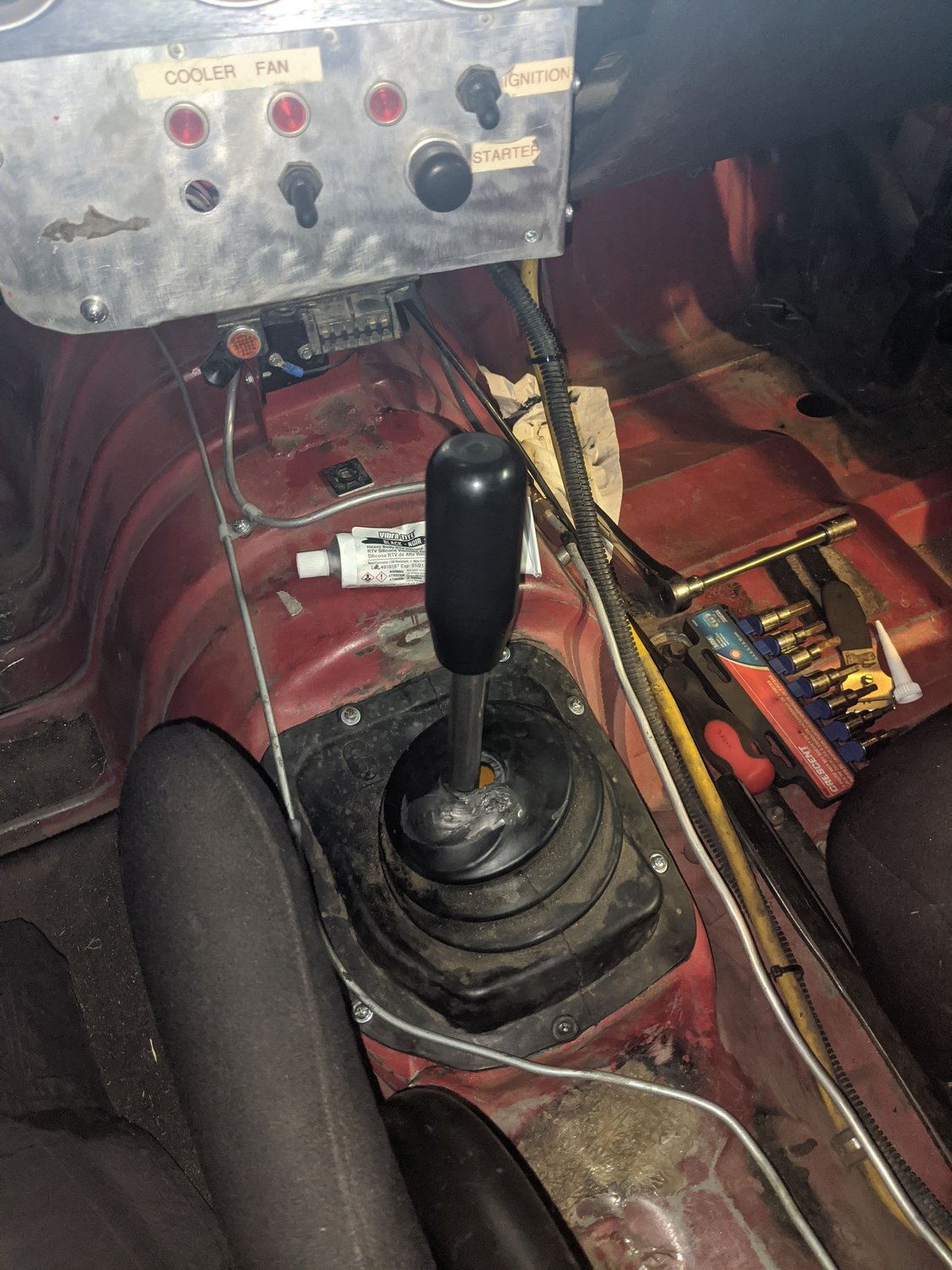

I do have the brass cup in there, just got the MGW in and it feels better in the garage. We'll see what happens at the track. How are your stock boots holding up with the MGW?
Mine doesn't look happy.
mine is the same lol. Small price to pay for quick shifts
You are supposed to cut the hole slightly bigger and slide the boot under the yellow block on the MGW
Old Jul 5, 2020 | 01:14 PM
Supercharged111's Avatar
Joined: Dec 2015
Posts: 931
Likes: 153
From: MI
The block that offsets the shifter? When I bought it they said once set, the orientation can't be changed. Does is still come off?
