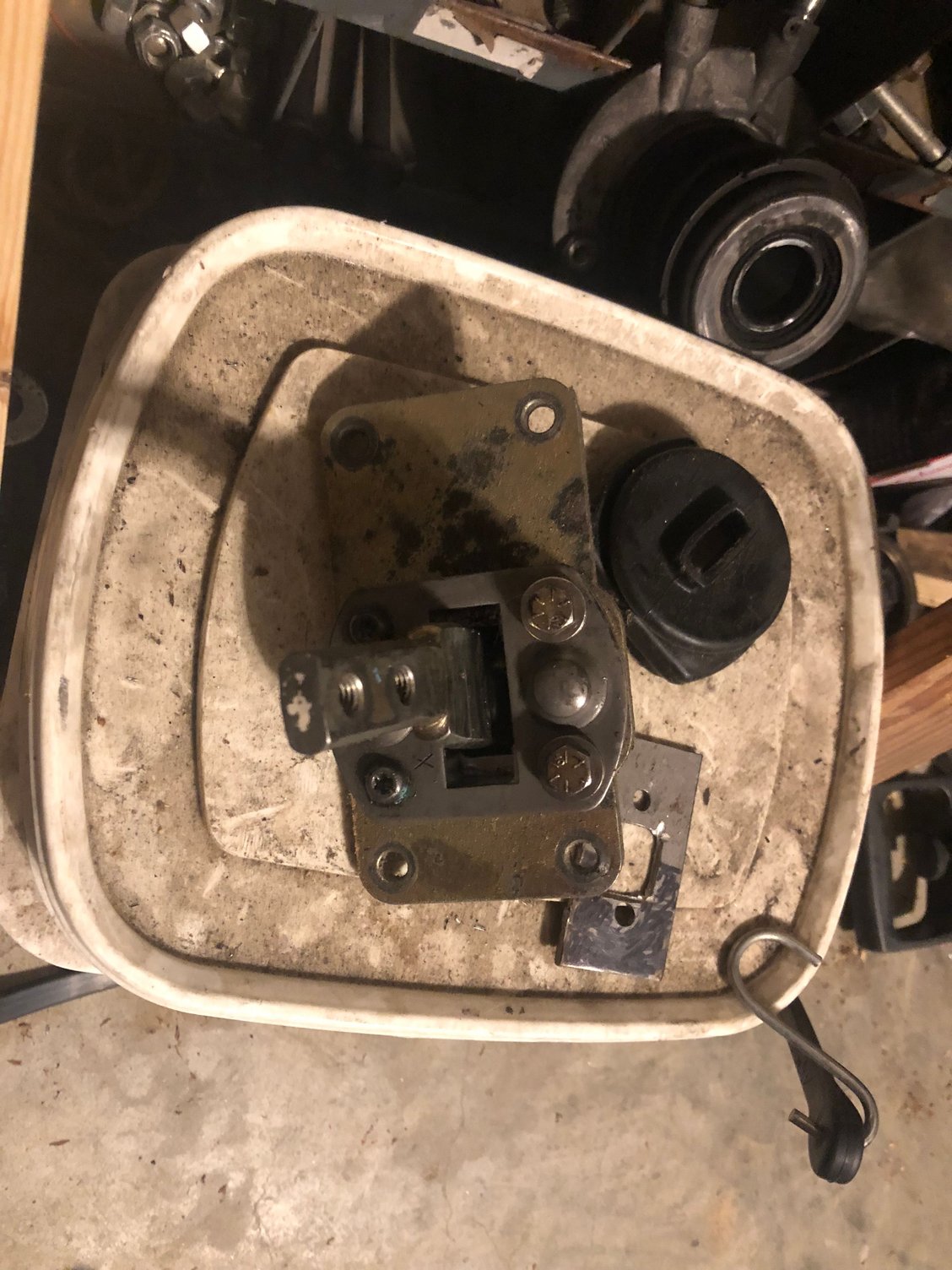

I’ve had issues going between 3rd and 5th gear with two different transmissions and two different shifters, it’s a real pain in the ***. With the old hurst shifter I took some 1/4 inch steel plate and cut it to fit the top of the shifter and bolt it in.
The idea was to have the shifter below the handles bolt holes, bump into the plate and only allow me to be able to go as far as 3rd and 4th gear. It worked but I got tired of having to undo the bolts in and out to use reverse.

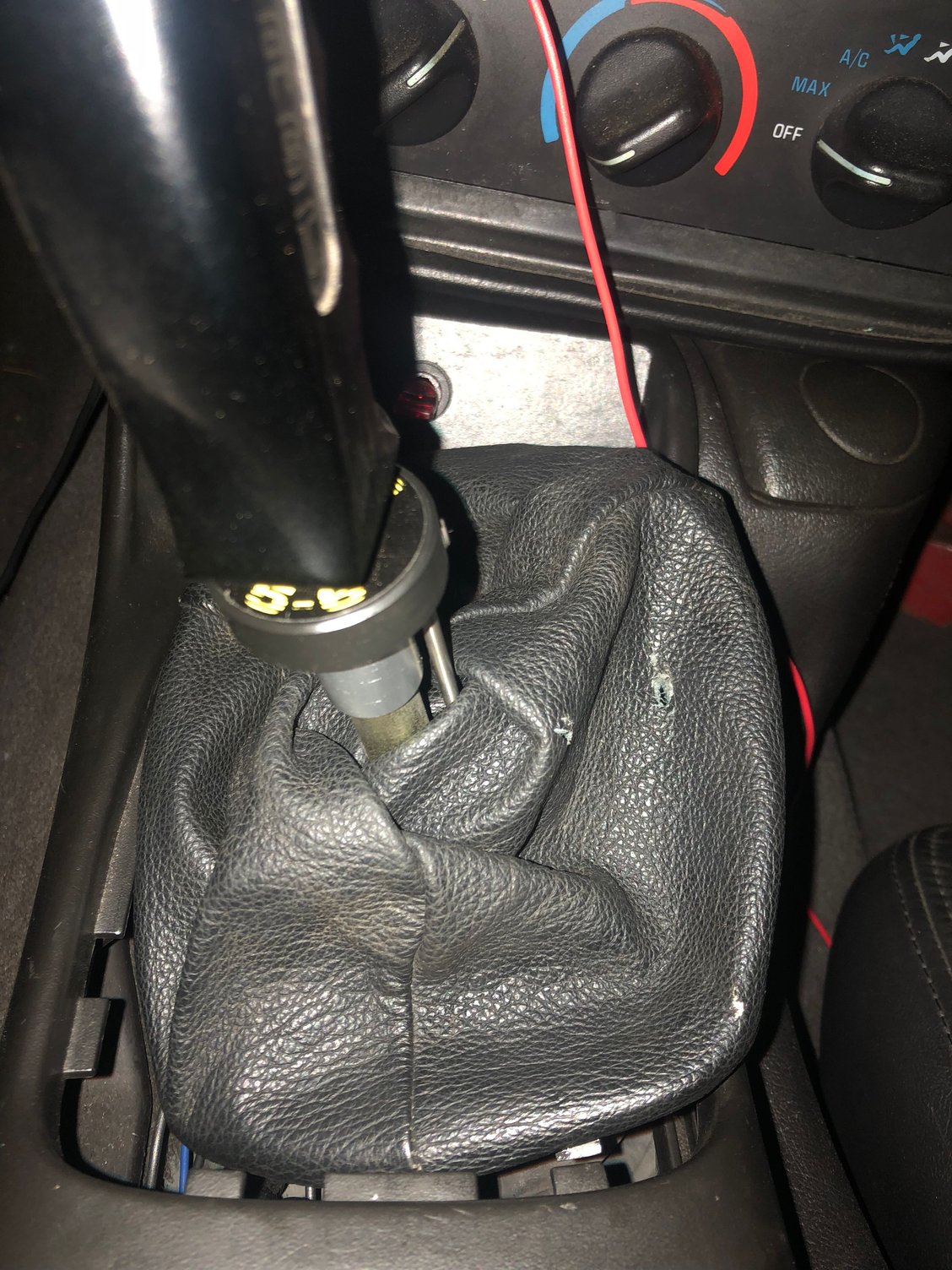

I have a pro 5.0 shifter now with an add on that has a rod that slides up and down to do the same thing. I kept breaking the shifter handle bolts on that and had to modify it to work like I wanted.

Old May 25, 2020 | 09:56 PM
nmass399's Avatar
Joined: Sep 2007
Posts: 1,244
Likes: 7
From: hattiesburg, Ms
Old May 25, 2020 | 09:59 PM

The top two are the hurst shifter, once the Plate is bolted on then there is no getting to 5th 6th or reverse. I had to grind the side of the plate several times to get it perfect, if not it would still go between 3rd and 5th
The bottom two photos is the 5-6 skipshift deal. Works the same way but it’s more convenient since the rod can be slid up to give back use of 5th 6th and reverse.
It didn’t work perfectly just bolting it on. I had to make a plate to bolt on to it also. As it came it would still allow it to go between 3rd and 5th. Added the plate and fixed that. If you want to go with a pro 5.0 and the 5-6 skipshift deal let me know, you will have to do some modifications so you won’t break your shifter handle bolts.
