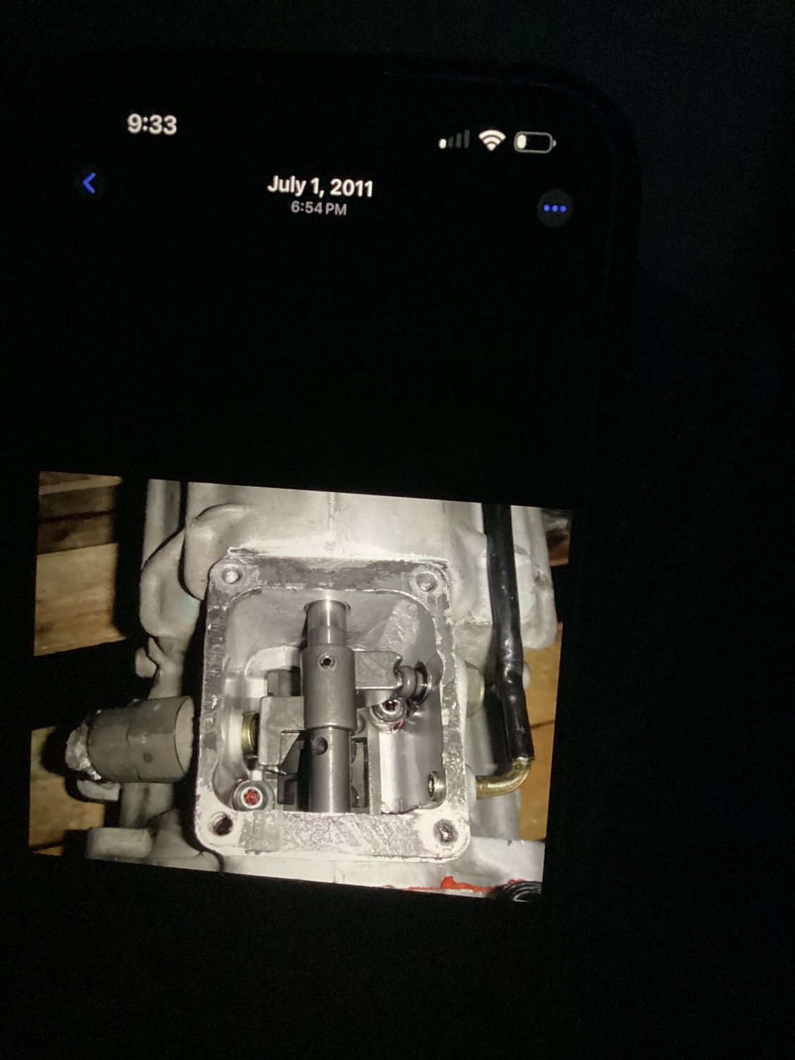

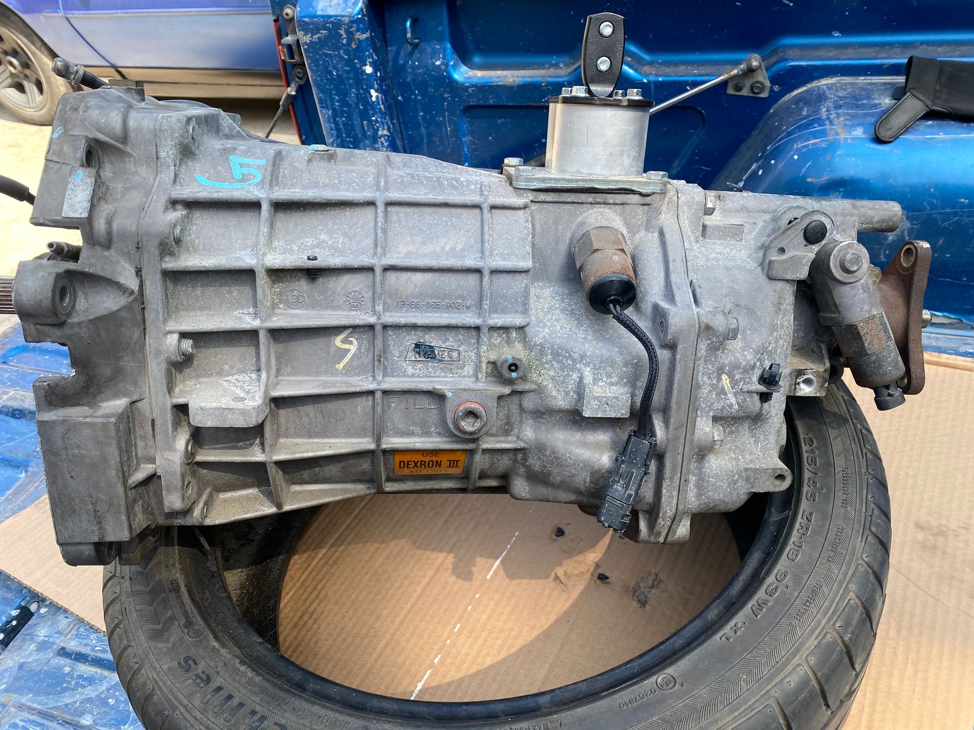

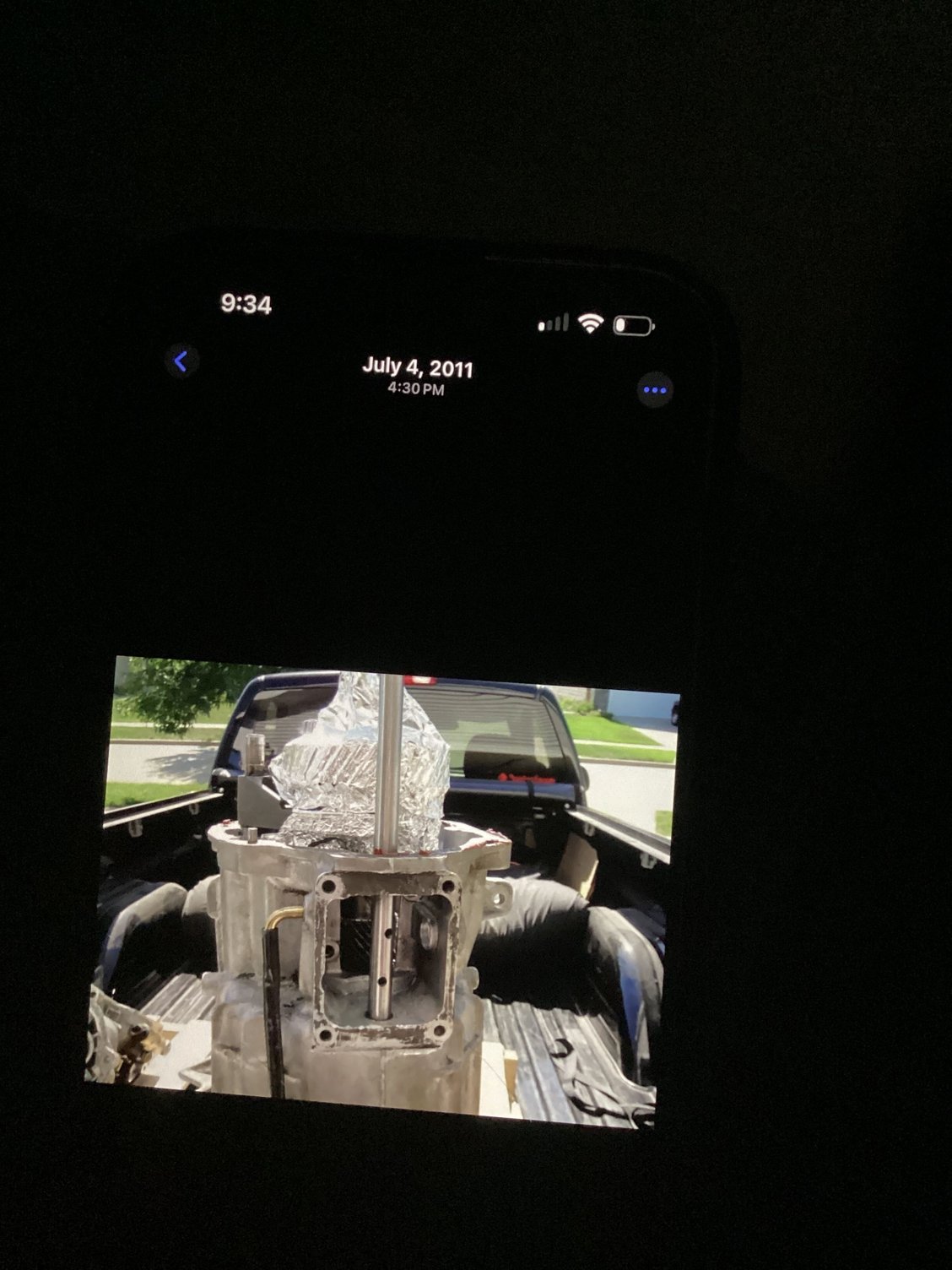

I have a t56 trans from a 2001 Camaro ss. Bought the trans off a local guy like 8 years ago. I just want to be sure it’s good cause I’m not gettin reverse at all even with the sensor off. I just want to know what to buy or what to do to make it work
Bought this trans like this but it has a mid shifter setup. Crazy stuff it has the fbody tail housing.
The back shifter location  I bought the fbody shifter lever
[img alt="This part it’s in the middle shifter
And this part hits not letting it shift to reverse. "]https://cimg9.ibsrv.net/gimg/ls1tech.com-vbulletin/2000x1504/image_03d507d273fa449918a6a11e5ba9a7b4beee418d.jpg[/img]
This part it’s in the middle shifter And this part hits not letting it shift to reverse.
I found this pic and it’s from a Camaro fbody.
Also seen that the shifter rod is one piece rod. Mines has 2 rods.

All gears go in. Except when i put that mid shifter levr on reverse is hard

With two rails, it's someone's former project / your new project with unknown changes. You can't service that rail without knowing how to line up the forward 1-4 shift interlock parts and line up the 5-6 rails and reverse rails with two guide bolts on assembly.
The guide plate under the mid shifter in yours isn't bolted down. The selector piece that goes on the rail there doesn't keep you out of reverse. The reverse lockout solenoid beside the *rear* Camaro shifter does.
You may have nearly all the correct Camaro parts to fix the rear shifter location, if that's your goal. The Tremec service manual can still be downloaded.

the gear selector piece under the mid shifter is bolted we just disassembled it to inspect everything.
the mid shifter is hitting the housing of the trans. Seen chips of material from there. We manually shift to reverse with no middle shifter and it goes in. I tried removing the sensors the reverse lock out and the other sensor and does the same. Further investigation it shows that middle piece is hitting the housing. Idk if the rods are bent or something. But I just want to know to buy the correct parts.
i have the tail shifter lever for a fbody already bought it. And I also have a mgw short throw shifter.
thank you sir. I appreciate the help

Your 2nd picture, post 10 has a correct reverse lockout solenoid / spring-loaded rash-thru assy. Black connector and pin extended. That prevents the shifter moving from 5-6 to the right into the R *gate*. If your shifter moves right with *force*, that part is fine. (It looks like it's a later model slimmer solenoid, not the 34mm hex T56 piece, which is fine.)
if your shifter fails to move forward into R but goes into 1, 3, and 5, you're going to have to figure out the internal rail assembly steps.
The CAGS solenoid left of the mid/case shift should be white connector, pin retracted unless powered. I don't know off hand if that being an incorrect rev. solenoid or defective "blocks reverse". But you can check with/without it. A good CAGS sol. with no power to it should change nothing from no-solenoid.
