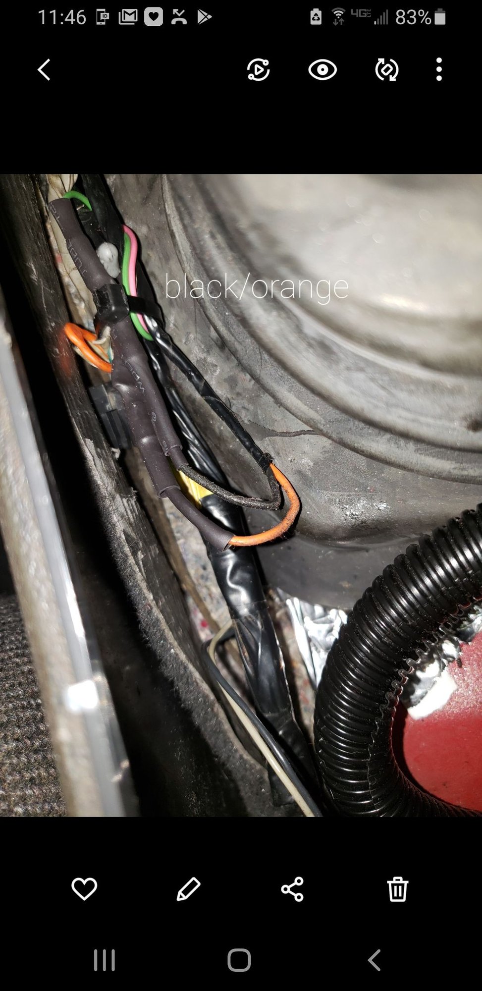

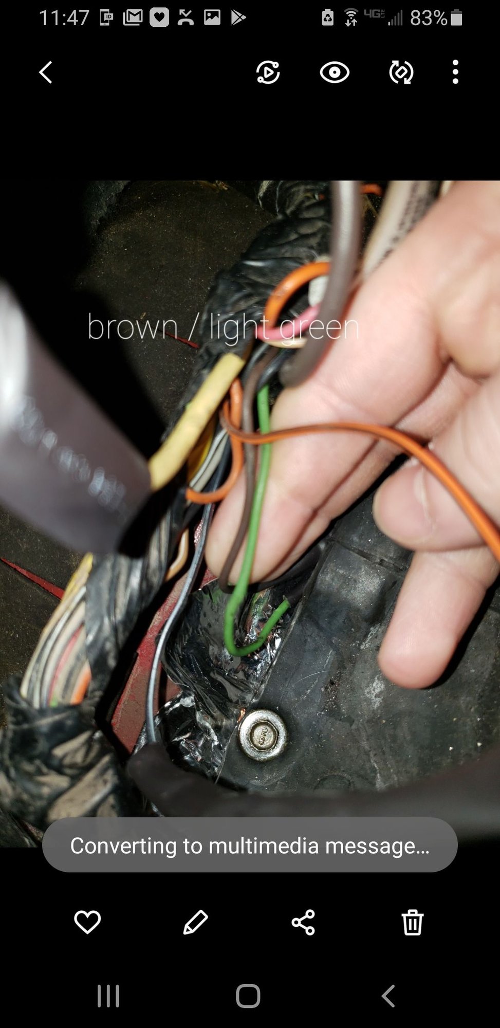

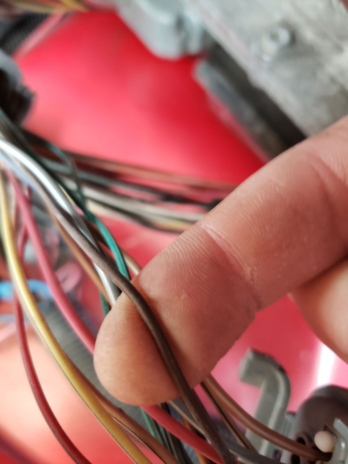

I want to make reverse lockout work like factory (95 lt1auto car 6sp swap) i know i need to run a wire from the blue pcm connector (D6) to side (B) of the lockout and side (A) to ignition power.
I have sifted through tons of threads, I'm fairly new to wiring but trying to do it right after all this time. I understand that for auto cars (D6) pin is Transmission TCC PWM sol control, where does this wire lead to? if its in the center console I may have it wired to the reverse lights? I am colorblind so wiring is difficult lol
currently my reverse lights work, reverse lockout is always disabled (able to shift into reverse always), and my speedo is working

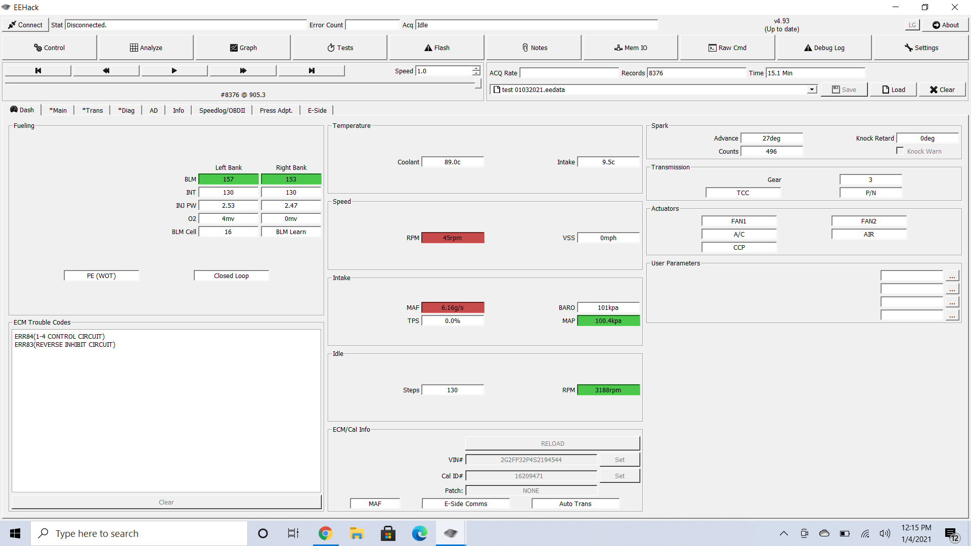

i've tuned my pcm using eehack but when i open the scan tool it still says my car is auto, and i throw two codes -err 83 and 84 reverse inhibit circuit (lockout) and 1-4 control circuit(cags?)
otherwise car has always ran great, just had to muscle reverse all this time and finally gave a shot at wiring it up.
TO REVERSE LIGHTS
WIRE FROM D6 PIN
CURRENT REVERSE LOCKOUT WIRING
lol I think I currently have my reverse lockout wired where the cig lighter used to be

i could really use some help wit this, i would like to get the car running as if t56 stock, i will restate, i have flashed the computer useing eehack but my datalogger still says the car is an auto. someone help me out with this wiring please!
