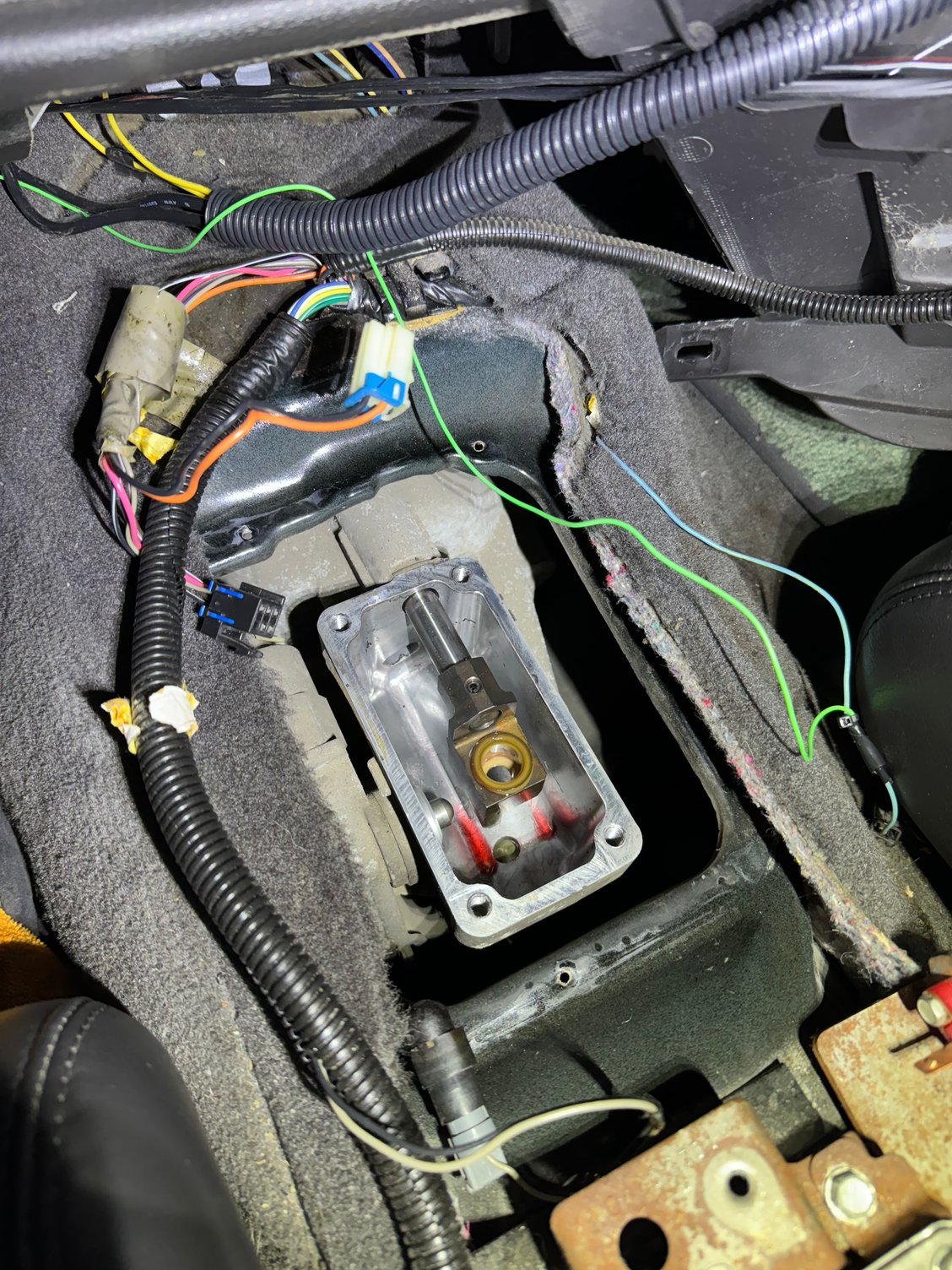

Changing my factory Hurst shifter to a Tick shifter and noticed transmission fluid inside of there, is that normal or do I have a leak? If a leak, which gaskets do I likely need to address?

Normal

Normal as stated. In fact, I fill my transmissions from there often, and always in the Chevelle. It’s zero mess.

You'd have reason to be concerned if there WASN'T any transmission fluid in there.

Came up through that little hole there and perfectly normal. Fill mine in my MCSS through the shifter mount, 1 gal in then shifter on. no mess and works great.
