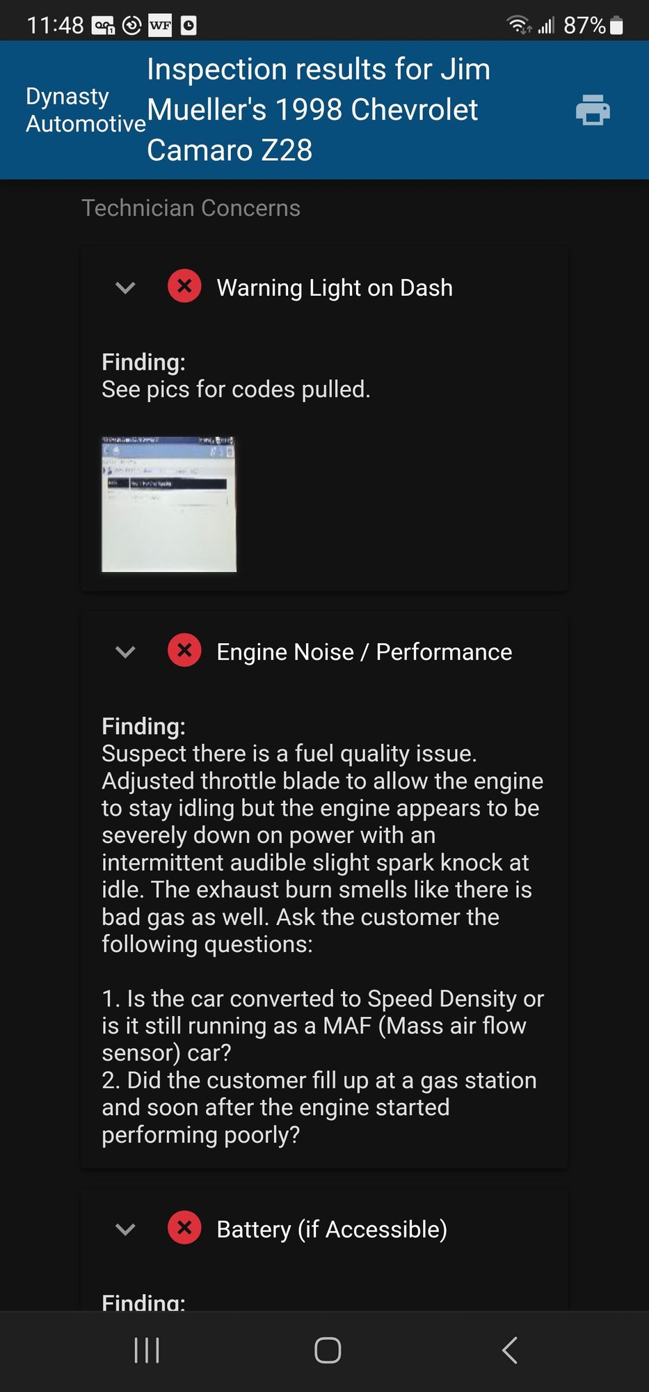

Fixed the rocker arm, back at shop for original concern about poor idling, fast rpm drops.

Shop says they are only getting 10" of vacuum on the engine. Will perform further health checks.

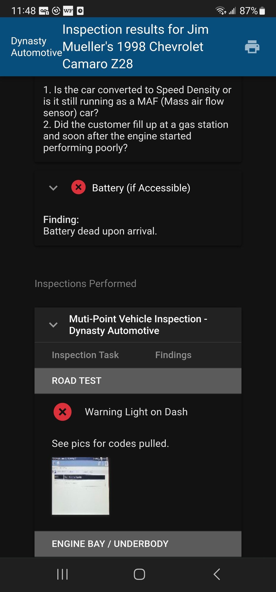

Shop found subjectively loose CHE bushing (bolt is tight), broken cam position sensor, subjective play in timing chain. Attempting to link media below, see 4 files with today's date.
