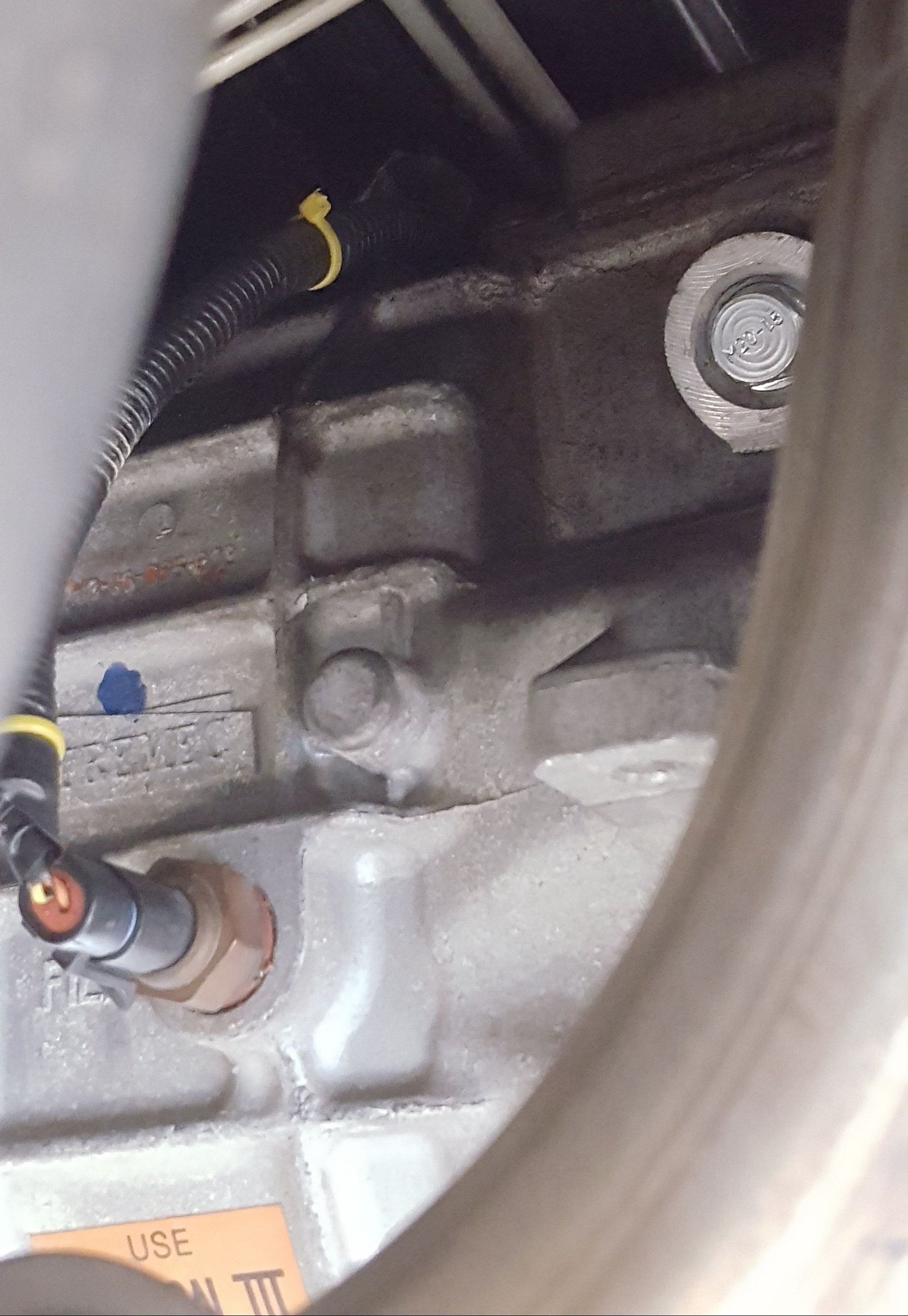

Dexron III goes in all my T56 Cars.
Pic for reference, my 2002 C5 Z06. You can see the sticker on the bottom of the Transmission.

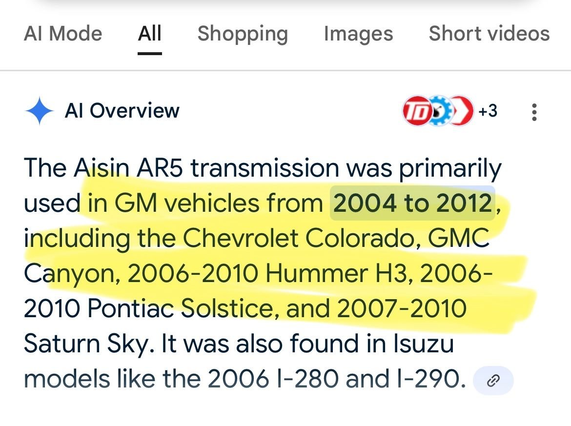

Aisin AR5 uses 75W90
Old Sep 3, 2025 | 07:29 PM
Y2K_Frenzy's Avatar
Joined: Jan 2022
Posts: 1,369
Likes: 256
Ah ha! I think now maybe we’re getting somewhere as far as why the thick gear oil type fluid superseded a Dex III type fluid. Maybe since the AR5 was more mass produced than the T56 after GM no longer licensed Dexron III for use in GM vehicles (GM 88861800) they only wanted to market one manual transmission oil. So instead of bottling up some Dex VI ATF and calling it “T56 Fluid” they just went with what they’d sell more of instead of paying two different bottling co’s.
