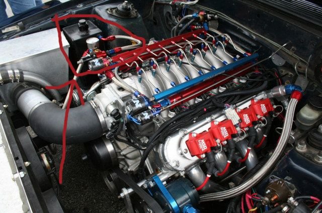

Probably the fact that OP mentioned above the tuner put in a fatter fuel jet and bumped the pressure up 5-10 lbs. The rich condition may not be as noticeable in a lower gear when the car is under more of a load, it could also be from some other variable, but we have ran through most of the common stuff already.
I saw on your tank that your return the fuel at the very top of the tank. In some of our development of our standalones, we found that we were getting alot of air bubbles in the tank and sucked back up into the fuel supply when doing it that way, that is why all of our standalone systems return at the bottom of the tank. I could see this being a definite possibility if the return was peeing fuel right on top of where the pump picks up fuel, especially as the fuel level got lower in the tank. That is just what we found in our own research.

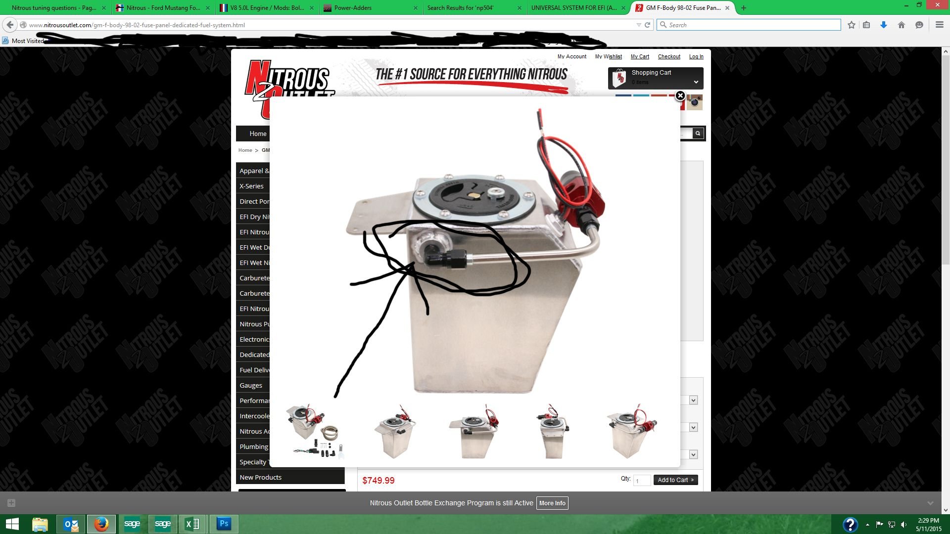

I saw on your tank that your return the fuel at the very top of the tank. In some of our development of our standalones, we found that we were getting alot of air bubbles in the tank and sucked back up into the fuel supply when doing it that way, that is why all of our standalone systems return at the bottom of the tank. I could see this being a definite possibility if the return was peeing fuel right on top of where the pump picks up fuel. That is just what we found in our own research.

Garrett, On a battery location dedicated the hose coming out of the top of the tank is the feed to the regulator. The bottom of the regulator is the return back into the tank.

I am not saying there is anything wrong with your product, however I am just curious to try and help the customer along. This is the unit he appears to have. That fitting that you are returning fuel to the tank is all the way at the top of the tank. This is exactly what I am talking about that gave us trouble with air bubbles in our initial R&D. Do you have a tube on the other side of this fitting to return the fuel right at the bottom of the tank? Or is it just an open hole "pissing" the fuel out the other side?

That being said the return does circulate back into the top of that tank. But the pump sucks from the very bottom where it is full of liquid. There is no problem with the design.
