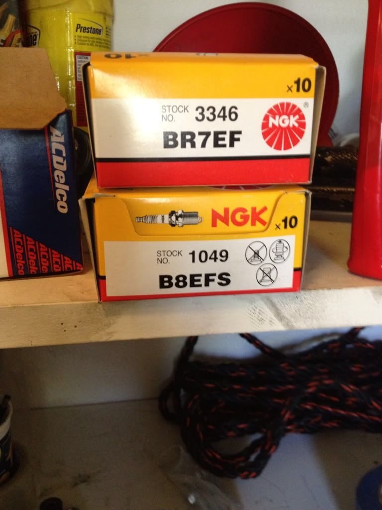

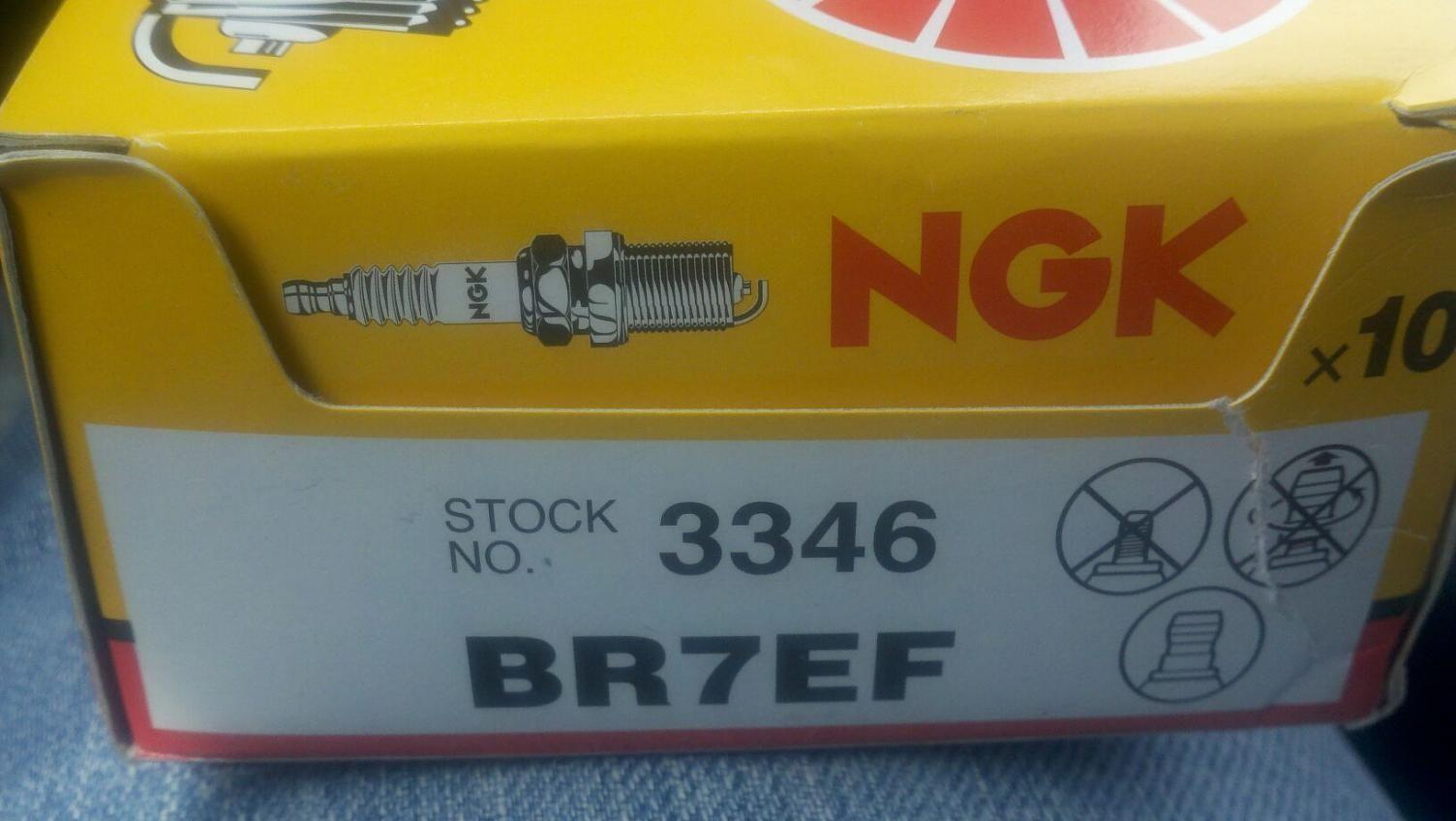

Old May 11, 2015 | 11:03 AM
NitrousExpress's Avatar
Ls1tech & Truck Sponsor
Joined: Jun 2010
Posts: 2,267
From: Wichita falls Texas
BR7EF and B8EFS pics for reference.
-Chris
