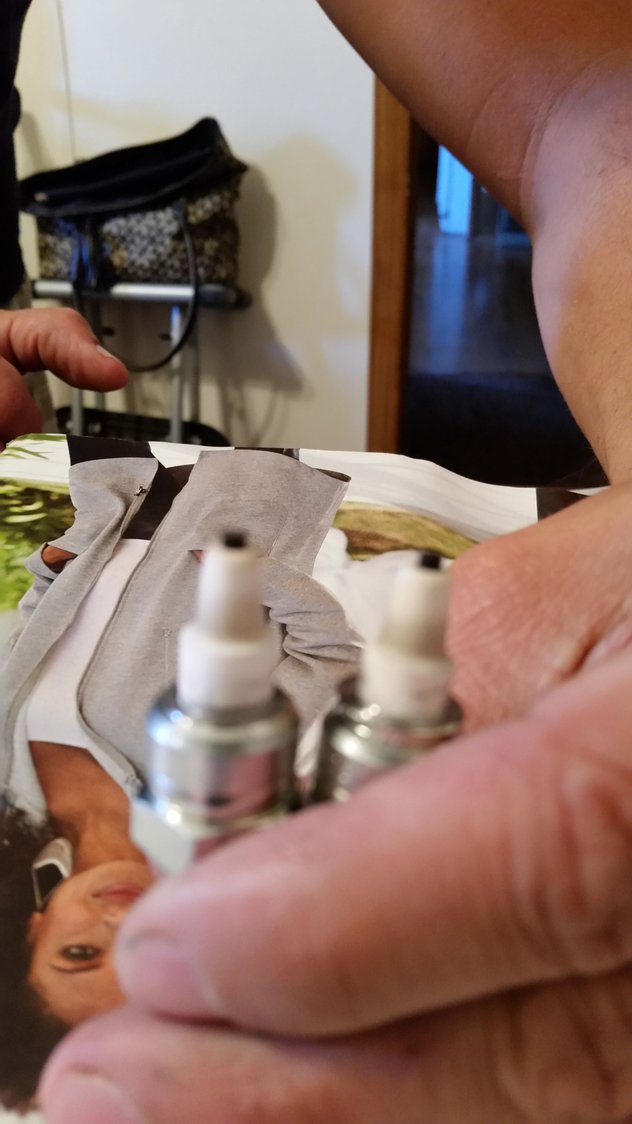

This is the same plug as above just cut.

Put BR7EFs in it, the plug you have is too cold. Also, you need to add some timing, and it's too rich.

I used a BR7EF and had 1 more degree of timing and a 31 jet (using 33 now) and was melting the strap off the plug. From where i am at now.
The one on the right .o33 11.5 afr the one on left is .028 12.7 afr<br/>

We are set ( BR8EFS) (.062N/.031F) 22* timing with 12.0 afr.
