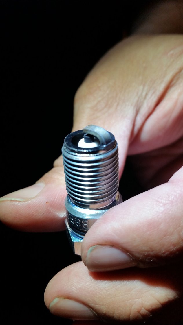

From: oklahoma
Well
.062N/.033F is where i ended up. I think my plugs look good. Here are some pics.

Well I ended up at a 11.5 AFR on my wide band for my plugs to look like this.

Is there any kind of idle time/ drive time on these plugs or is this after a full hit with immediate shutdown of the engine?
-Chris

1/4 mile pass immediate shut down.

What gas are you using?

91 pump gas.
