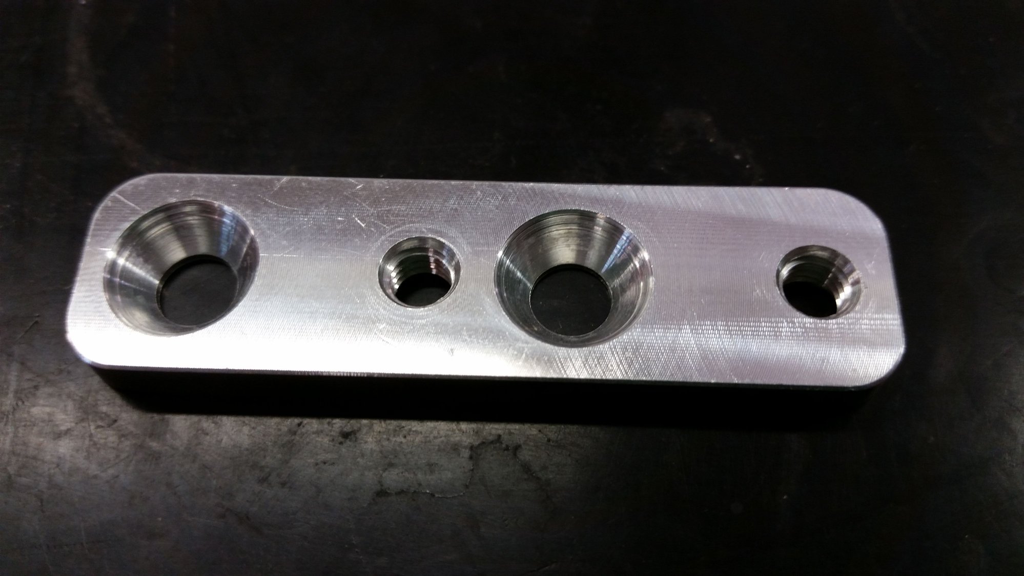

You will need to get or make a throttle extension bracket that will space the linkage forward to compensate for the plate thickness.
Something like this...
-Chris
