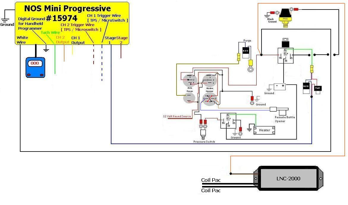

I'm not sure if that would work or not since everything is wired together. I'm about to post the wiring diagram I used minus the bottle heater and purge. Its definitely pulling timing. It flashes as it should when I arm it and I know for a fact its plugged into the coil packs correctly lol. This is my first time ever spraying. It ran great on motor, and still does. I've seen where lots of people have had problems with #7 fouling out so I'm about to check that. I've been letting my car cool down since getting off work. Lane tuned it with TR6's in it. I don't believe that should make a difference as far as tuning goes but I may take it back to him in the near future to have him tweak it for nitrous
Old May 8, 2018 | 08:20 PM
97TAsom's Avatar
Joined: Sep 2015
Posts: 159
From: Cullman, Alabama
This is the wiring diagram I used. Everything works as it should. I believe it is either a plug or a bad plug wire causing this issue. It may be misfiring under WOT on motor but just gets amplified when I spray it. It pulls hard on motor though
