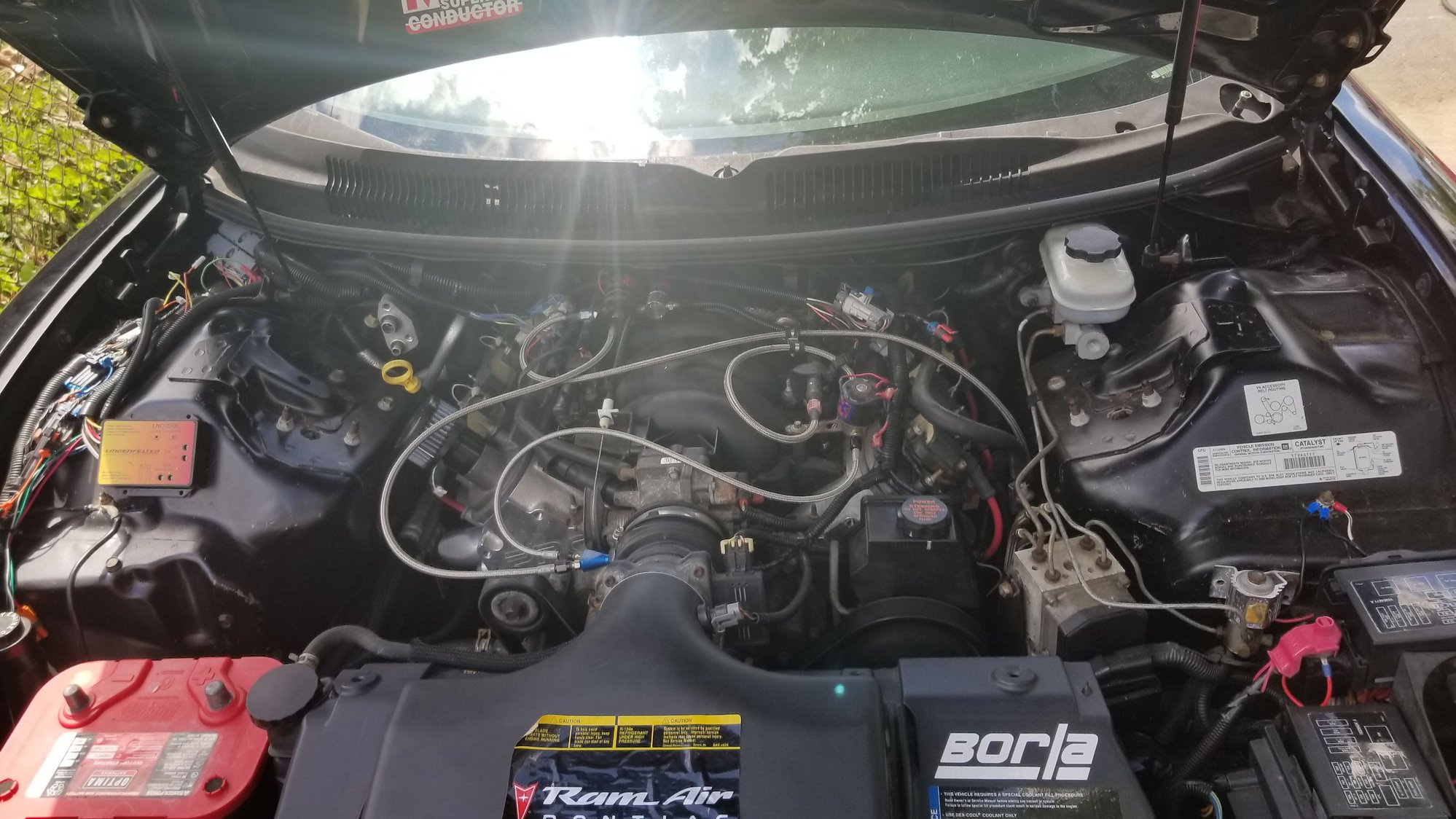

PFA
so im getting roughly 1.3 percent slip on my nos speced fti sst converter when running on motor. How much of a shot can i run to get optimal sliipage/performance out the car. mods in sig.. Thasnks
