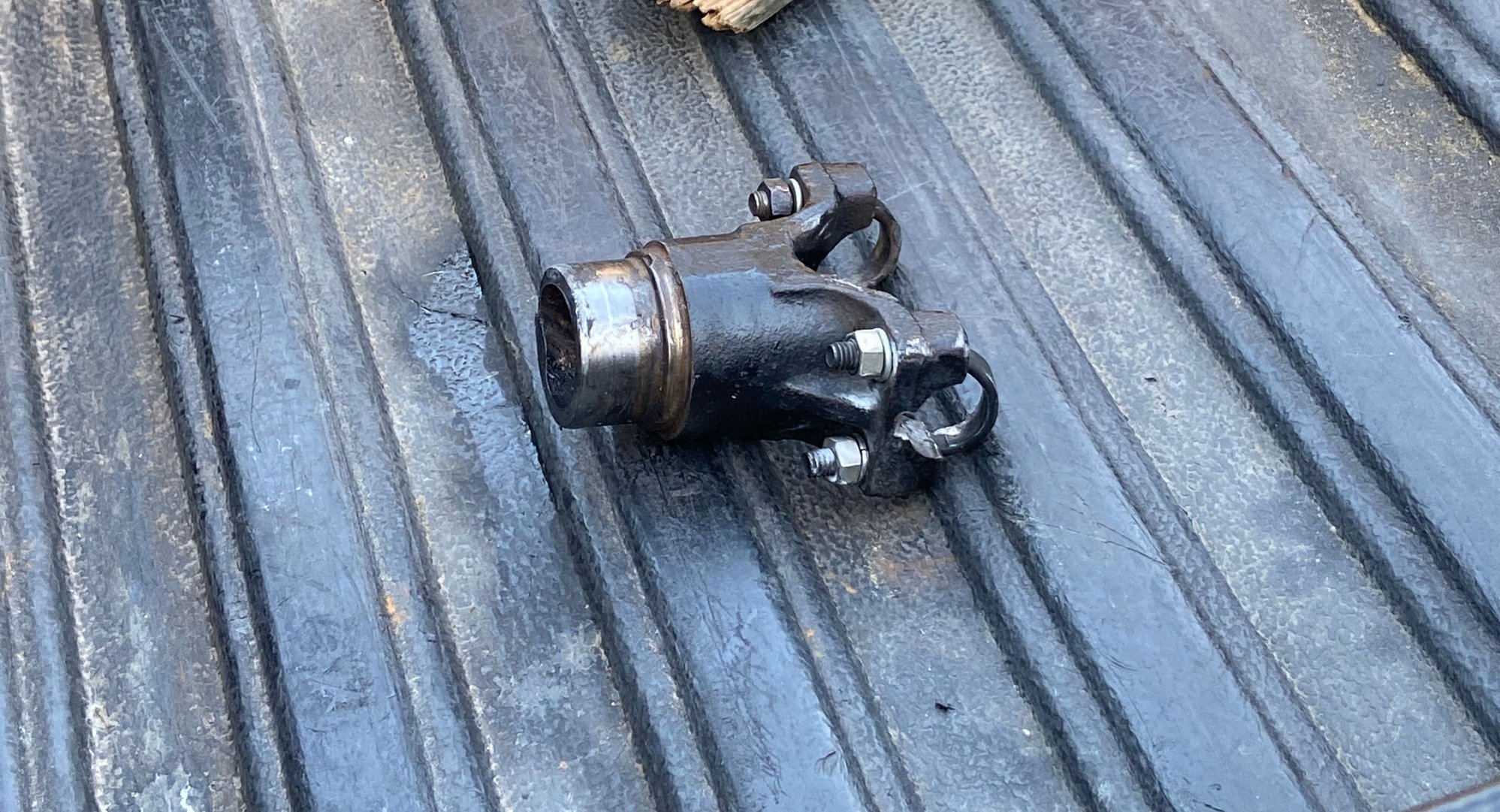

Took it back to the track Saturday NA. Did one pass and let off. It lifted the front tires a bit leaving at 3800rpms, let off and got back into it. Went 7.52 to the 1/8 ...
When I went for a second pass I didn’t leave the line. I had a lowering block on the car and it expanded when I launched causing the rear end to shift up which broke my drive shaft and the drive shaft broke one of my caltracs lmao .

Putting blocks in the rear and planning to race isn't a smart move as you found out. Adds to the leverage on the spring perch.
