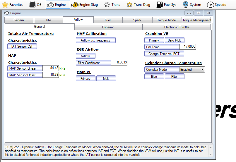

First, change the cylinder charge temperature drop down tab to "disabled". In the description at the bottom, it shows that the airflow calculations would all be biased totally towards the IAT.

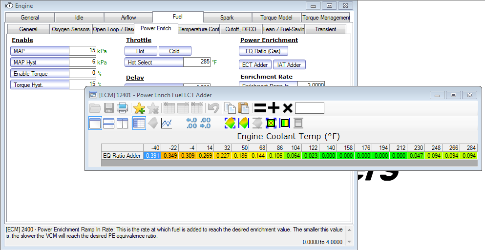

Then, go into the power enrichment table and find ECT adder table. Let's say we trick the ECT sensor into thinking it is hot...at the top end of the table 284, I can add as much fuel as needed to make the wideband happy

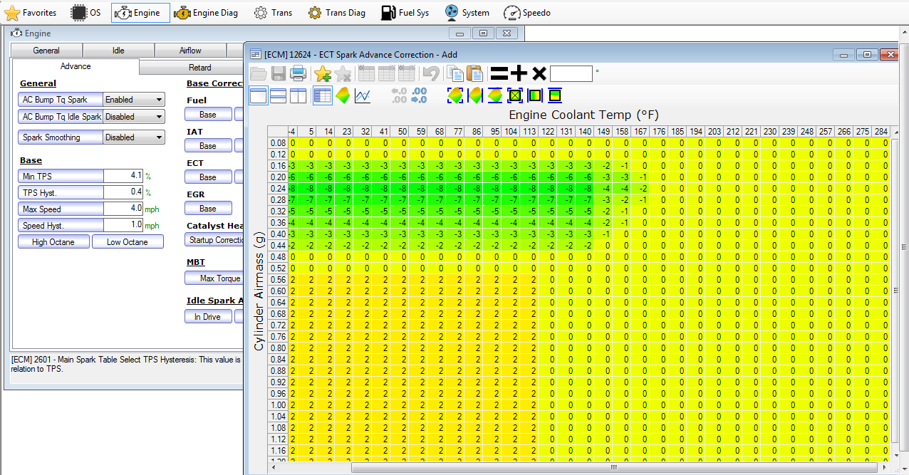

Then for timing control, find the ECT Spark Advance Correction, and again at the top of the temp range 284, change however much timing I need.

1. if I disable the complex cylinder charge model...will the PCM even use the ECT tables I've mentioned?

according to nitrous outlet jet chart you need to add 19 pounds per hour of fuel for a .035 jet 42hp shot. You can figure the percentage of fuel that is compared to one of your logs and that should get you in the ball park of what you need to add for fuel.
You will probably need some by rpm compensation to keep afr consistent using eqr but you can calculate what rpm you need the biggest % and then apply that across to get started. To be conservative add 10% to you calc just to be safe on a 35 shot you will be ok if your off a little but as you go up you can get a sense of how concervative your starting point needs to be.
