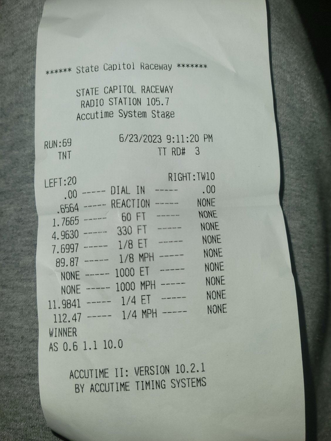

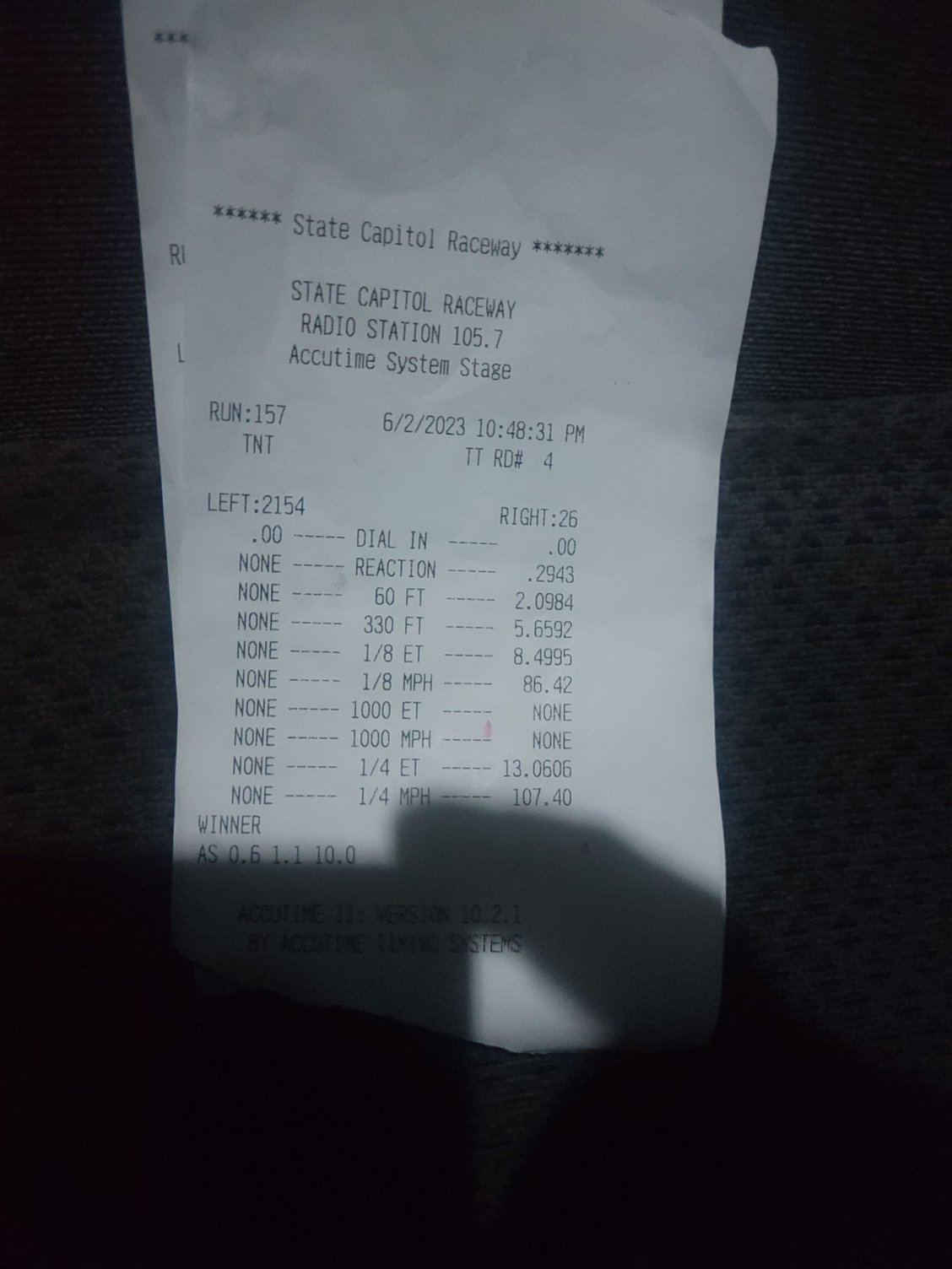

So my single cab silverado likes about 32 degrees timing NA. I have 150 shot of nitrous on it and I'm trying to improve my mph and time slip a little. I'm pulling 13.0/ high 12. Im putting 5.5 degrees of timing back in the truck on the spray. Do you guys think my numbers would improve a bit if I put a little more timing back in it. Was thinking of putting the 200hp jets in it but wanted to see if timing would help me first. Oh and the truck runs on e85. Thanks

What do the plugs look like? That seems like a lot of timing already. You could even pick up pulling more timing if its unhappy where it is now. What does it run at the track? Is is consistent? Trying pulling a degree or two and see if it gains ET or MPH, then go the other way until it doesnt gain anymore. Read the plugs tho. You can always add timing, but you can't pull timing after the engine lets go. No one can say yes or no if you can add or not.

the plugs actually look pretty clean, forgranted I just put them a few weeks ago. So on my lnc2000 add a few degrees it what your saying. Maybe go to about 8 or 10 and work my way back to 6? This time was me not spraying 1st gear and it coming on in 2nd from a windows switch because it was spinning bad. I've ordered a progressive controller and new tires and hoping to play with the timing and get it down in the 12s

work on the 60ft before anything else. suspension, tires, practice etc

Dont have to go that much. make a run as is, then pull like 2 more and try to do everything exactly the same. See if it picks up, if not, go back the other way. add a degree from your original 6 and see if it picks up. definitely work on your short track tho. that is going to make the biggest difference.

it was spinning bad off the line, I couldn't spray 1st. I ordered some mickey thompson ee street R , I have some already but they were getting a bit of age.

ok I'll try that, I'm going back next weekend so ill do those things and see if it helps. I picked up a progressive controller and new tires so now I should be able to spray off the line so I'm hoping that will help. That and a little more seat time as well. I've only took the truck to the track a few times

Im getting there!!
