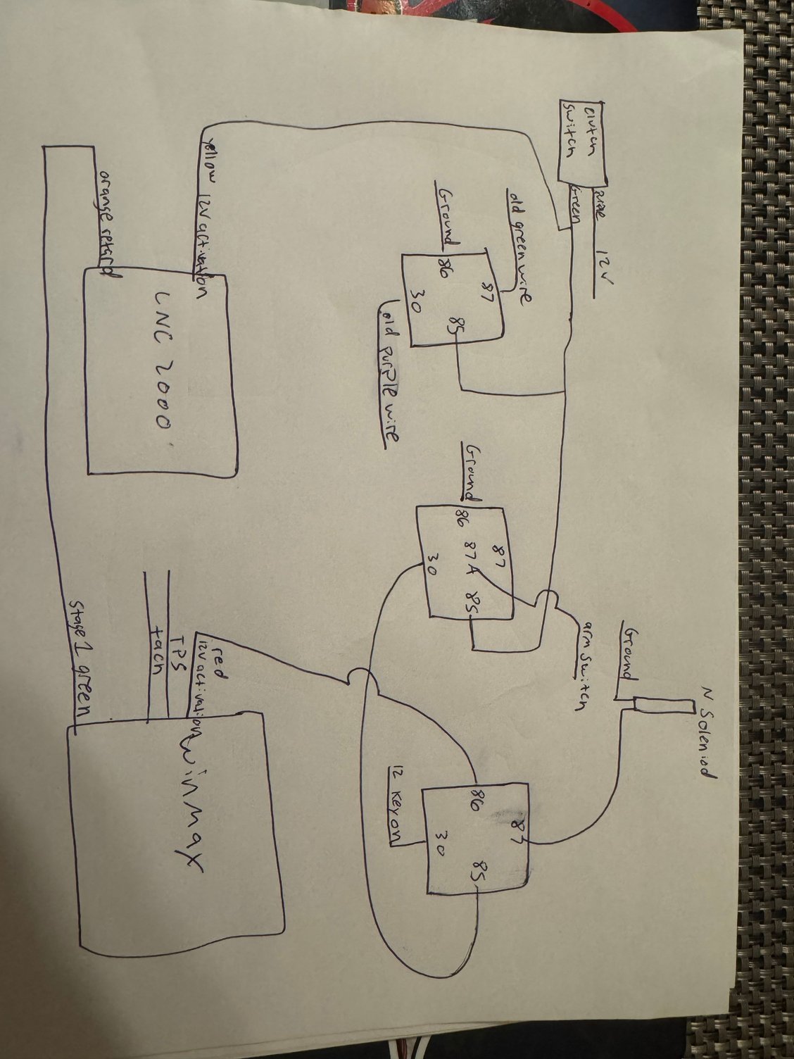

Originally Posted by chvycmaroz28
Just looked over this appears to be the exact way I explained it to you & the same as mine. For the heater & purge wiring I can send you that if you don’t already have it.
Old Dec 9, 2025 | 06:14 PM
chvycmaroz28's Avatar
Posts: 251
From: New Hartford,NY
Thats already wired from last car but thank you. I’m being told by people who do it for a living that it can be done with one relay but if this works I’ll do it
Old Dec 9, 2025 | 06:21 PM
Dbosarge16's Avatar
Joined: Jun 2022
Posts: 31
Likes: 8
From: South Alabama
I don’t think the nitrous solenoid portion could be done with one relay if you are using the 2-step off the clutch switch. Maybe you are referencing running the heater and purge with one relay?
