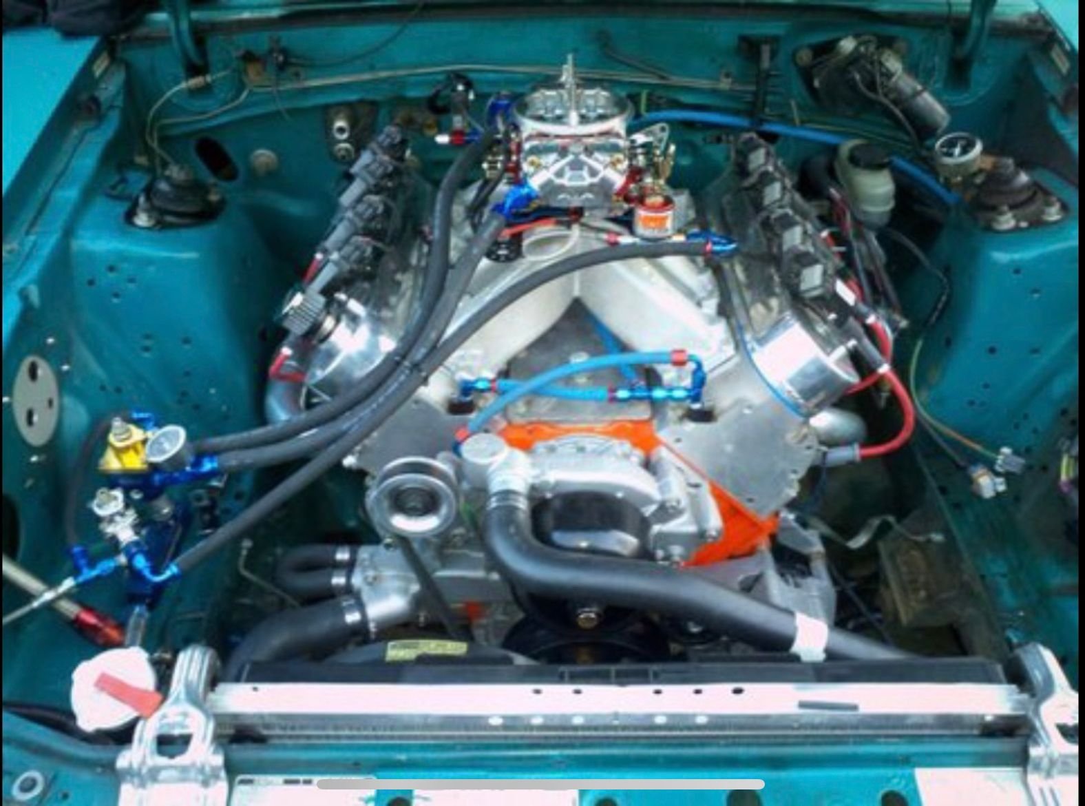

Looking at setup ideas of how fast ppl been with a nitrous sbe 6.2 in a foxbody

Pretty sure, with a sbe ls3, untouched heads, cannot recall the cam but I think it was something like the old stage 4 btr ls3 grind (233/250)... My buddy's fox was either a low low 9, or a high high 8 at high 140s/low 150s. He's a small fella (maybe 150 soaking wet) but the car was probably 3300 with him in it.

Not sure where my text went. SBE 6.0, NOS cheater system. 9.8s. 140ish.
Turbo 400, circle d 4200 Convertor. 3.90 gear
