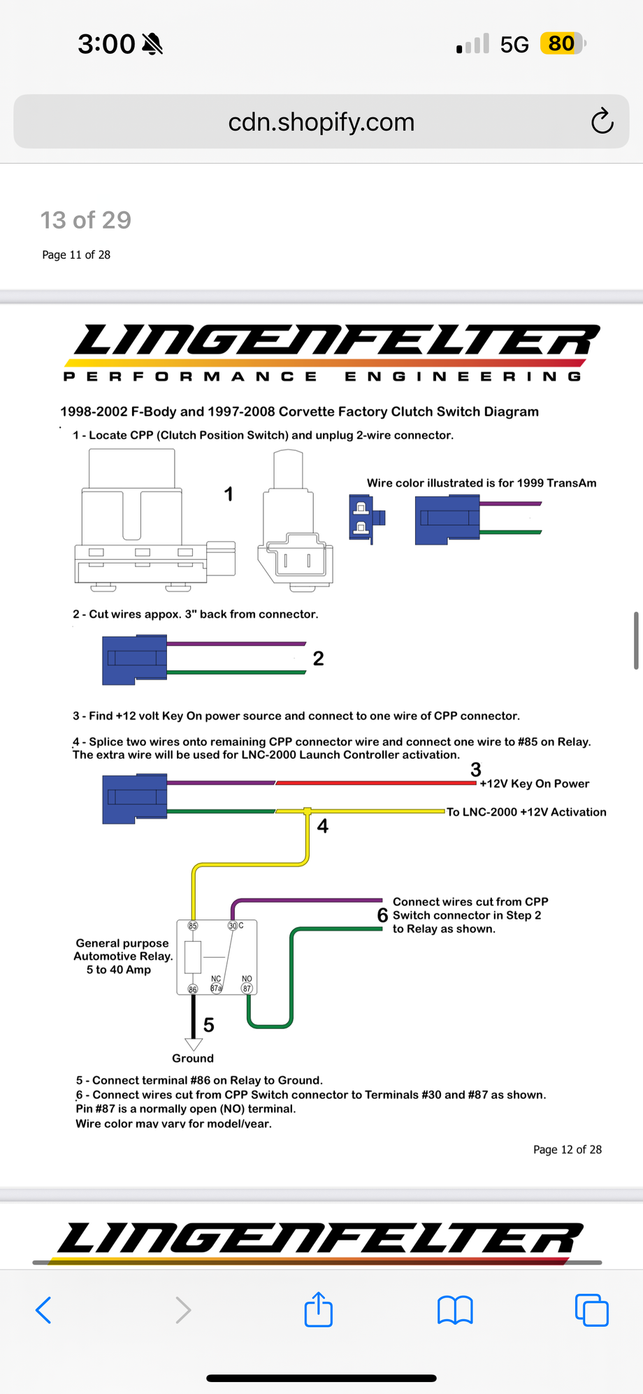

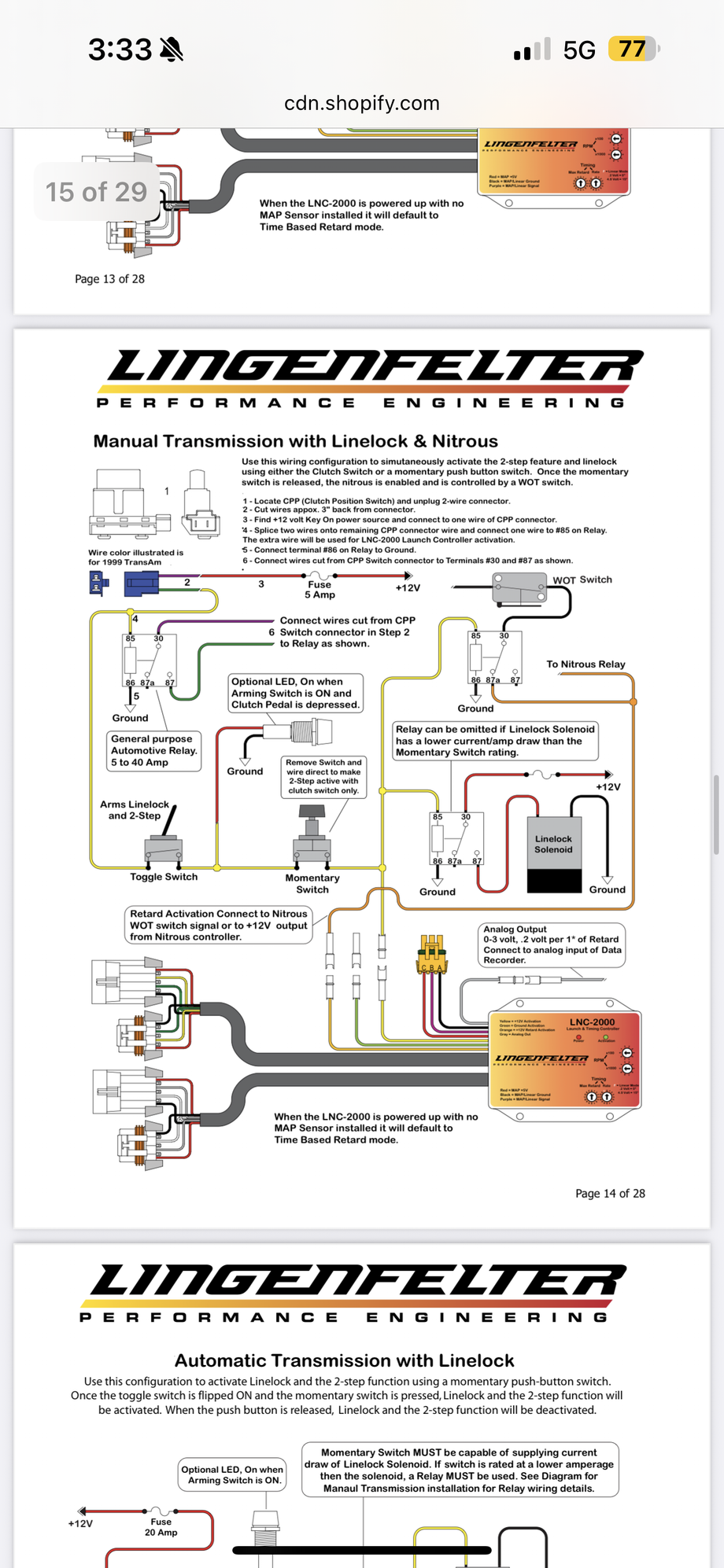

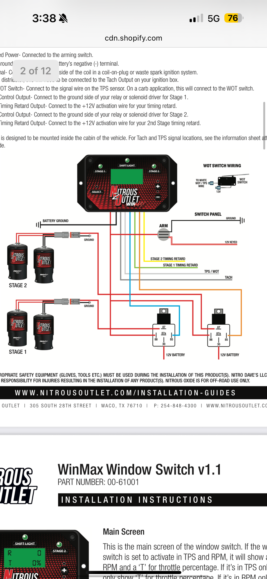

Can anyone help clarify how to wire them so the 2step is active when clutch pressed and so nitrous will not activate when clutch pressed? I have the diagram from the lnc2000 instructions but the nitrous part of it is confusing. I have a nitrous outlet winmax controller. I know some of u may think it’s black and white right in these photos. But can u dumb it down for me? Lol
