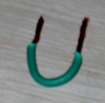

Yeah, that's how you jumper it. I attached a pic of my jumper wire below so you know what it looks like. When you turn your ignition to the "on" postion it will kick the fuel pump on to pressurize the system and then it will shut off, it should hold about 50psi. So when you bump the system with the ignition on it will give a quick spurt then die off. If your fuel noid is dead you should see no fuel or just alittle trickle. It's easiest if you have someone in the car to arm the system and step on the pedal so you can really watch what's going on. No problem with all the questions, don't hesitate to ask more if you need to.

Wow this is the fastest I have every gotten answers from a forum. Maybe I will ask another question . is the wire just plain wire for electric with the little strands once you strip it or is it one piece once you strip it or does it not matter. Thanks again

Just kidding. It's a normal wire like 14 gauge or so, just strip the ends then twist the strands tight with your fingers.
