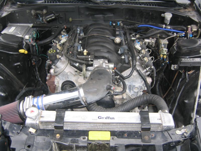

heres mine
Old Aug 17, 2005 | 06:23 PM
1MEANGTO's Avatar
Posts: 891
From: minneapolis,mn
[IMG][/IMG] heres mine
