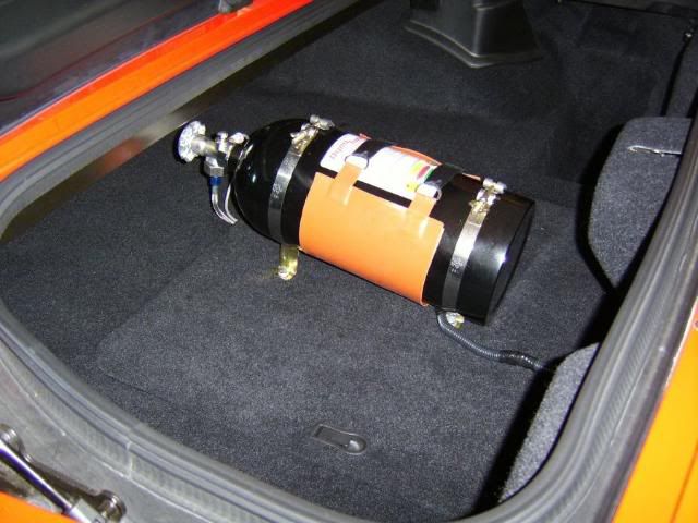

This won't work for you because of your electronics, but here is what I am doing.
I have since swapped the -8 fittings to black, Carpeted the uncarpeted parts of the well's, and sent off the black bottle blanket to get a embroidered C-5 Logo on it.
Here is the Blanket with a paper logo for size reference
Waiting on a Billet Bottle Bracket, a manifold for the bottle gauge/Heater switch/remote pressure gauge and a gauge pod to start. Vinny at 860 is likely going to double check my install and do the LC-1 wideband install (hoping in March).
Cheers
Beer

Here is the final on my bottle setup.
DynoTune Billet Bracket, Heater and Bottle Opener.
Only things pending (bottle wise) are wiring it up, running the Main Line, and getting the Blanket back with the C-5 Logo on it.

Cool, Beer, nice set-up. One thing I have done recently is add black velcro straps around bottle blanket. It makes them a little tighter and cleans up the look somewhat. I'll post pics soon.
