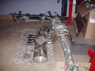

Yep, you sprayed outa the hole, at 4000rpm. Be careful on spraying to much coming out of the hole or you'll be doing this to get at your axle. Ask me how I know what a large torque spike will do to the stock axle. What did you run on the spray?
Robert
I love the ingenuity there Robert! You got that vette up high!
Robert
OKAY that's a 'carnage' pic. Hope it goes back together well.

Well I made over 160 hard azz launches, but knew this was coming as I had an hardened output shaft on my bench. Going to go the full monty while I have it apart.
