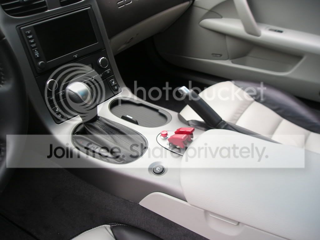

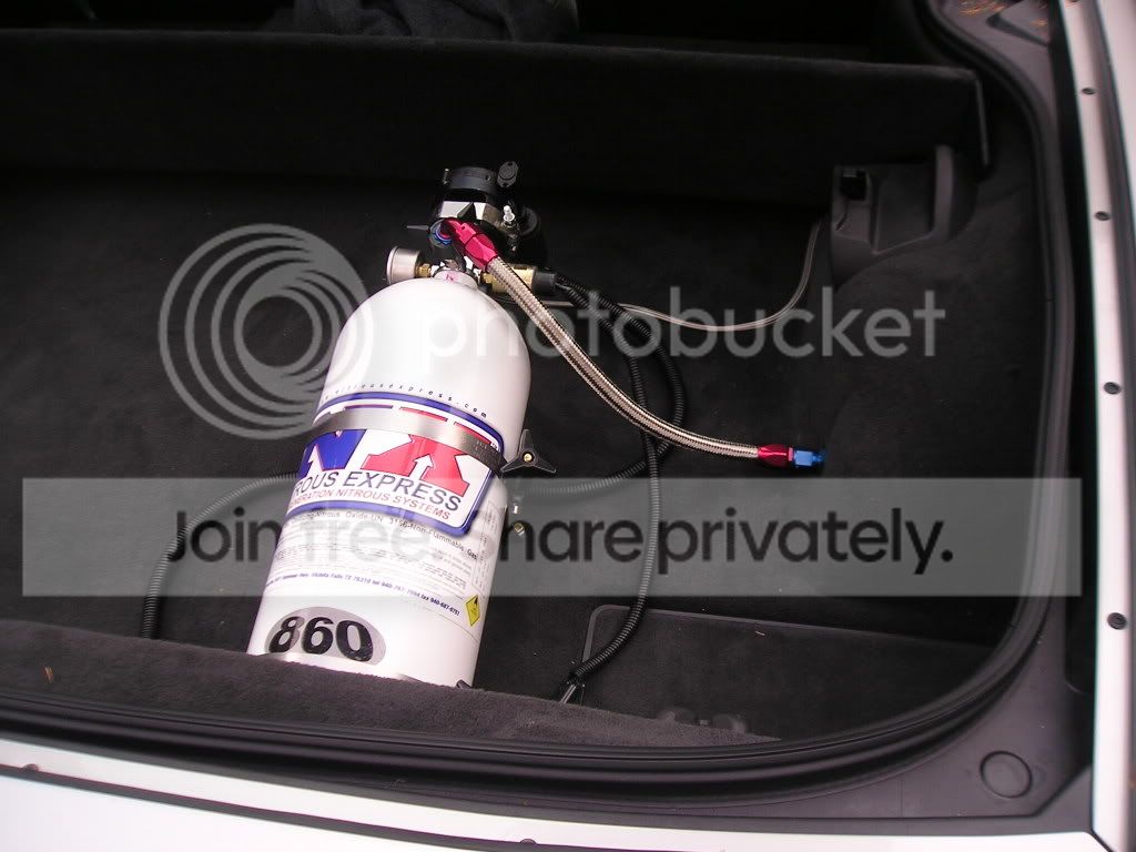

Here is Daves plate kit with custom harlines, 860 bottle heater, Trick/FJO window switch, NX opener, purge, etc.

Looks really good. I like the hardlines for sure. So, to make the hardlines you need some aluminum tubing (what size?), a decent tube bender a flaring tool and what fittings? Not played with this stuff for years so, any pointers would be great!

These are stainless steel lines from NX. You need a really good tubing bender and flaring tool. Also remember that these fittings are 37deg flare, not 45deg like most autoparts stores sell.
Oh and one more bit of advice is to buy plenty extra line

So do nitrous lines require double flare, or just the basic flare? I would also LOVE to run hardlines on my plate kit.....

single flare works just fine.
