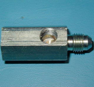

if mechanical gauge, then you will need the AN T fitting. then the line, then a -4 to 1/8" adapter.
HOWEVER, i think you sound like you are wiring an electric gauge, where you only need a Single Hole Purge/Gauge Adaptors
