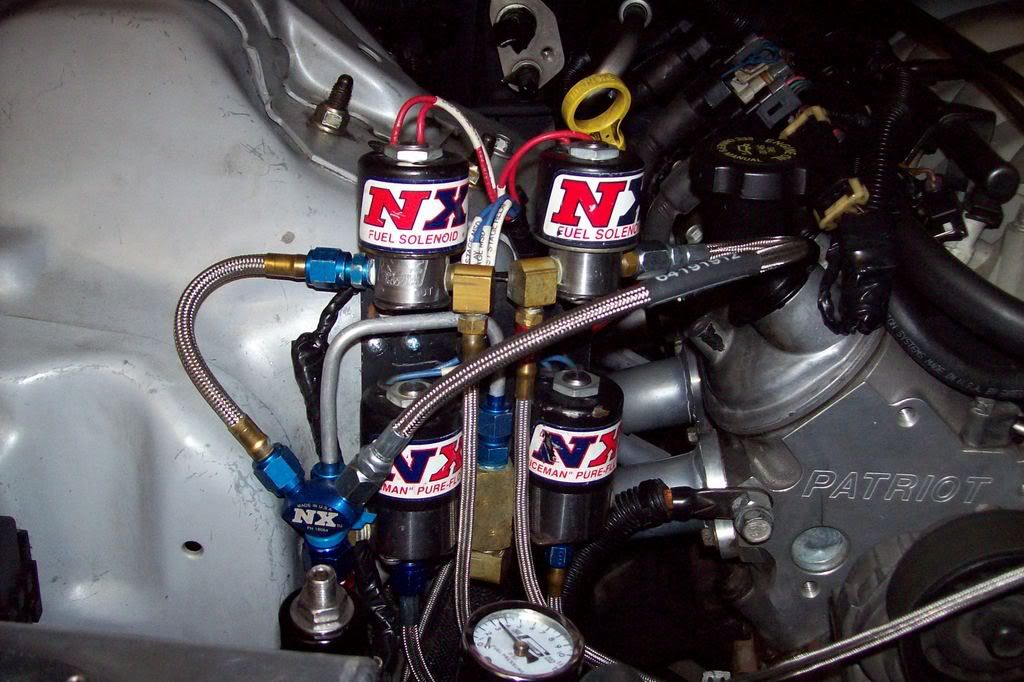

here is the vid thanks RAY@NITRO and for helping me line this out. I got to make only one pass at midnight drags and a huge storm came in. The A/F was only at 10.2 on this run I went back and adj. the fuel pressure on my standalone to lower the fuel pressure and went back to the line and it poured rain. So low 10s are almost there. This is a 100 shot first stage and 3 sec. out another 2nd stage comming in at 60% and ramping in 2.5sec.

Congrates on the new times. Get the airfuel to 11.5 to 11.8 and you will be set....

Very nice....I guess our last changes worked

Yea, I change all the fittings and swaped that T out and replaced it with the Y

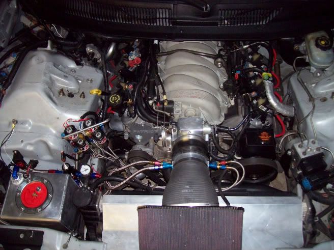

here is a better pic. I know its nothing for show. But this is a daily driver and gets me donw the track.
