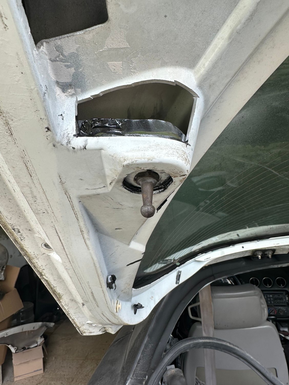

I know that it’s been over a decade since this post was put out and I’ve looked and looked for a concrete answer on this matter and never found one. I decided to post my solution just in case someone else has this same issue and I’m sure there has to be. I faced this same problem 12yrs after someone asked for help on this problem. See attached fotos for reference. Sort of self explanatory but feel free to ask any questions.
With a dremmel I cut out a piece of the fiberglass to see what I was dealing with. Save the piece for later.
Removed the strut mount or whatever you call it to sand and scuff up the inner edges for the epoxy to grab on to.

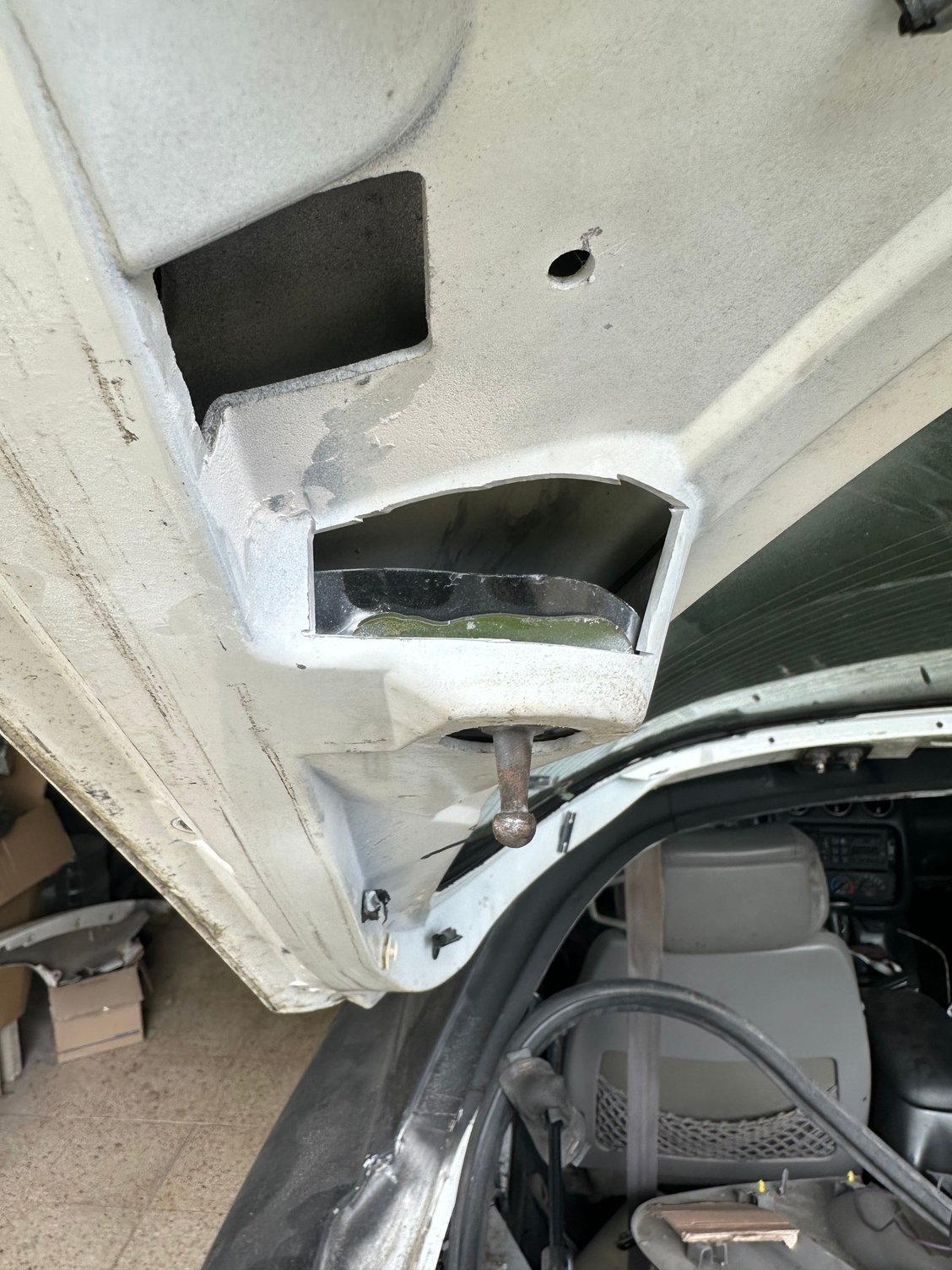

I centered the piece, applied professional grade epoxy and wedged a piece of hard foam to keep it down.
After the expoxy has dried.

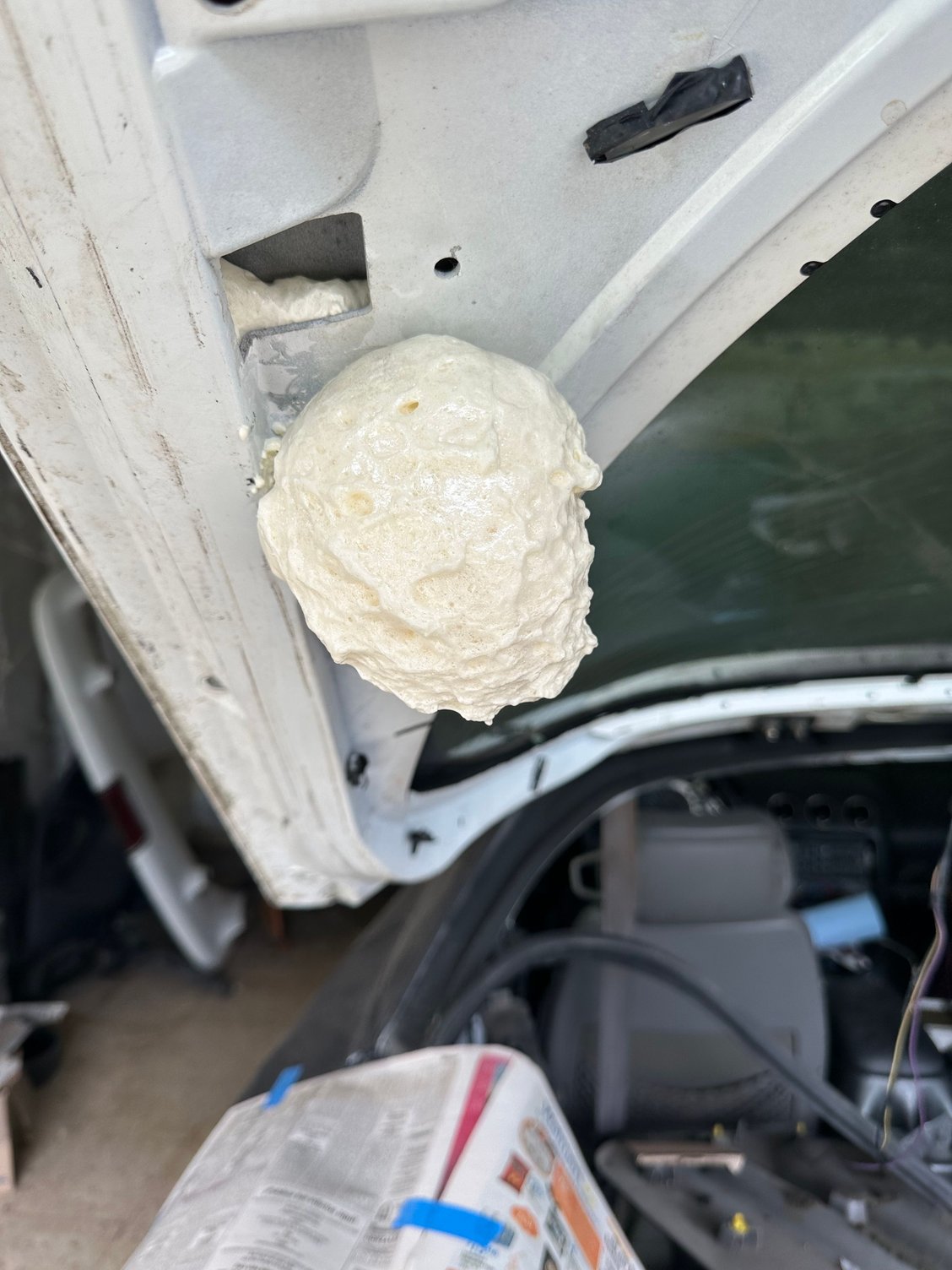

Expanding foam.
Put enough foam to fill the area for maximum coverage.

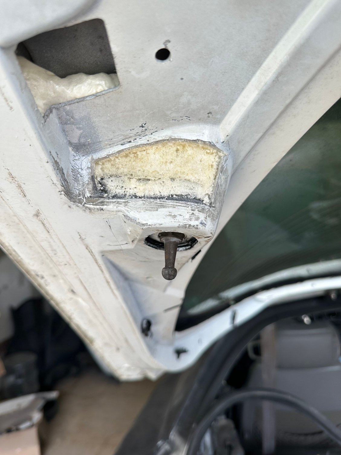

Cut the excess foam.
I glued back the piece of fiberglass I cut at the start of this project.

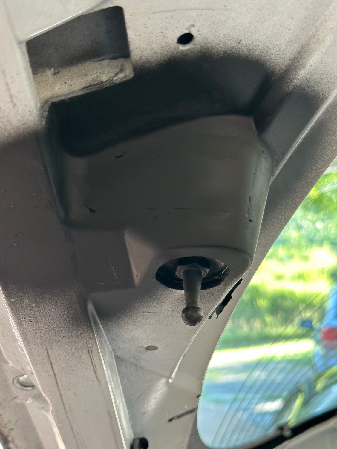

After a little filler putty, sanding and paint. Good as new.
