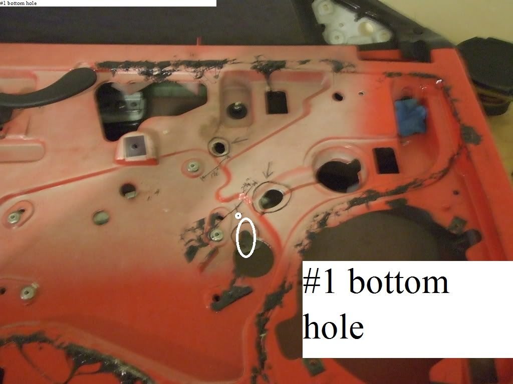

I'm unable to figure out how this electric window motor position is. I believe the motor is somewhat parallel to the big round surport bar inside door and slitely upward at wire connection end.
I've fought this thing for over 2 hours yesterday now 1 more today. searched over 20 hours for a image of a motor installed, I dare you will never find such image you are suposed to know how to reassemble. problem is I started this door swap 2 years ago an forgot the position of motor.
I see the holes used on the old motor. but for the live of me so far can't agline the motor w/ the holes and yes I did bump the motor down a tad still can't aline never had this problem the many times I replaced prior window motors.
if I could figure out what hole one #1 is on both motor and regulator or if someone will share the trick to line the gear w/ reg. these motors swaps would be much appreciated.
