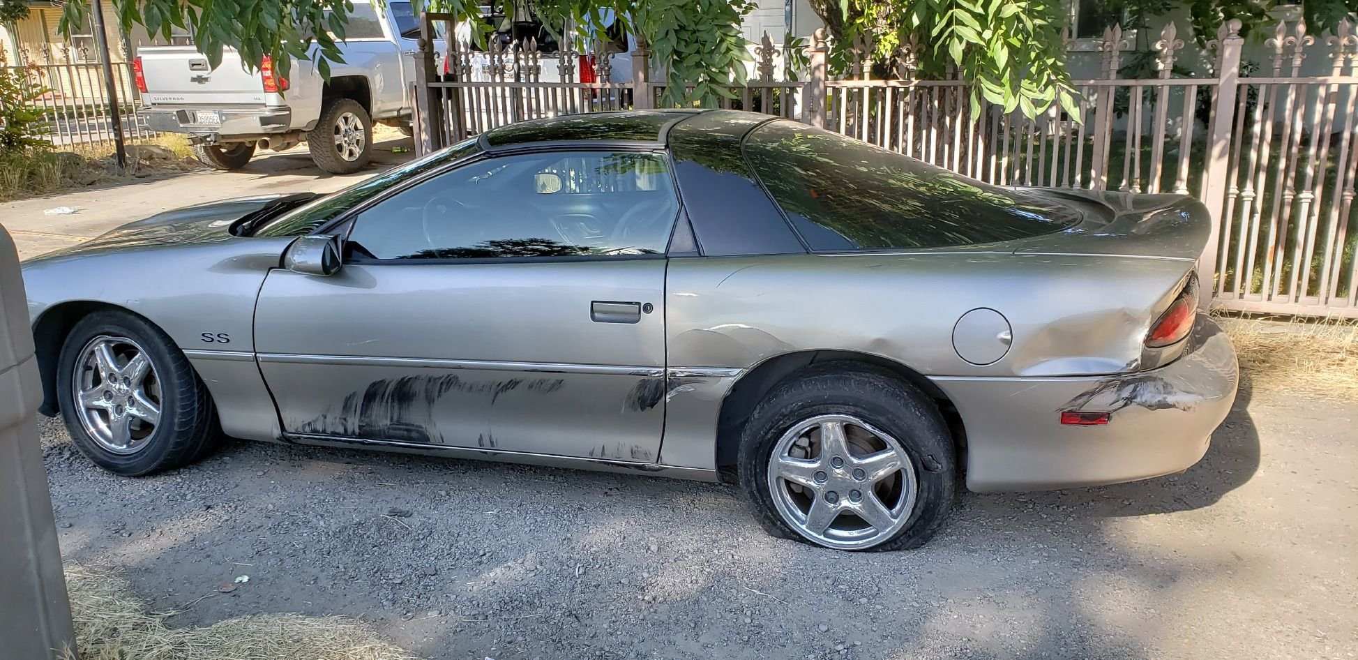

How much would to repair my damage? What would need to be done? Is it worth repairing? Any advice would be highly appreciated

A competent dent puller, paint, 2 wheels, 2 tires, looks like upper balljoint or control arm, possibly a new axle shaft. Depending on any cracking you may need to get the door patched or replaced.
The cost depends on who does the work and where you get the parts.
If it's worth fixing depends on more info than you provided.

I paid 5k for the car , I already have a set of corvette rims to throw on it , The only damage to the door it that black scuff on it , Id still have to replace it ?

Check the inside of the door and also around the catch on the back edge of the door. You're looking for any cracks. If everything looks good then you should be good to go.

Looks repairable...how is the drivetrain and interior? Low miles?

I checked inside the door and their is no damage , Pretty much all the damage is shown in the picture . The car has 120k miles , and the Interior is perfect.
