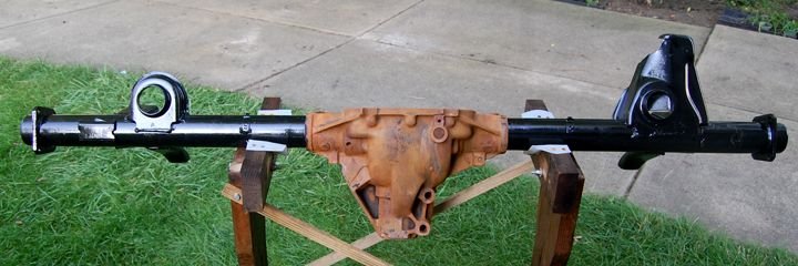

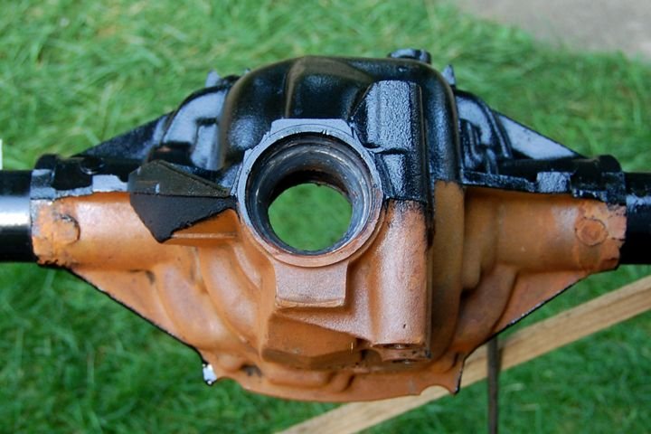

I've been using POR15 now for about 15 years. Rust is hygroscopic and pulls moisture out of the air. The moisture in rust is part of the curing process for POR15. Removing old paint and flaking rust is necessary. Any spots taken down to bare metal has to be 'rusted', easily done by wetting with water to attain that classic rust orange color.

POR15 is not intended/designed/formulated to be used on bare metal and new panels.Bare metal and panels need to be etch prepped with their 'etching' formula.
When I use POR15 on freshly cleaned bare metal (steel and iron casting), I purposely wet it with water to let it 'rust' to form the rust orange patina.
