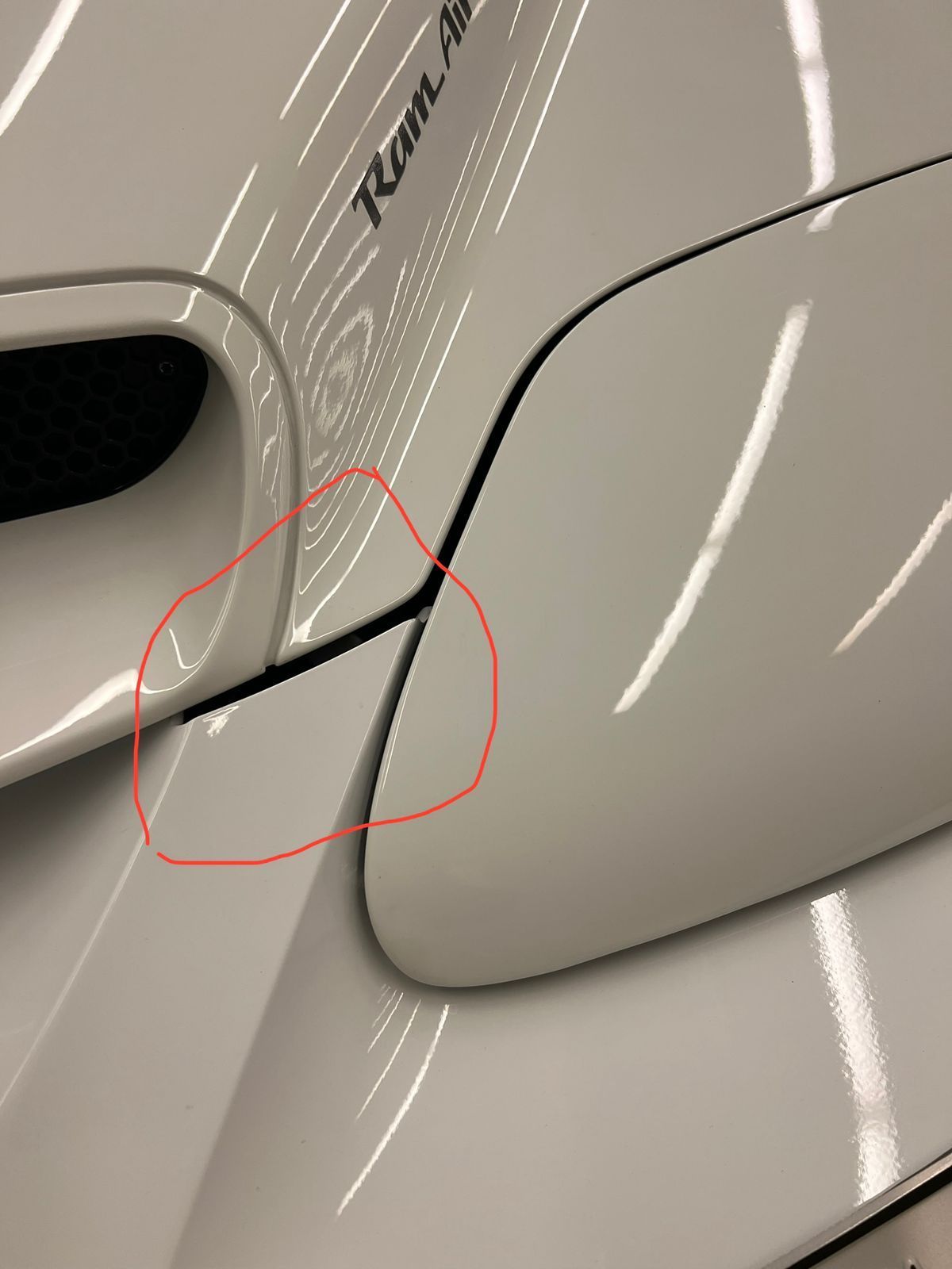

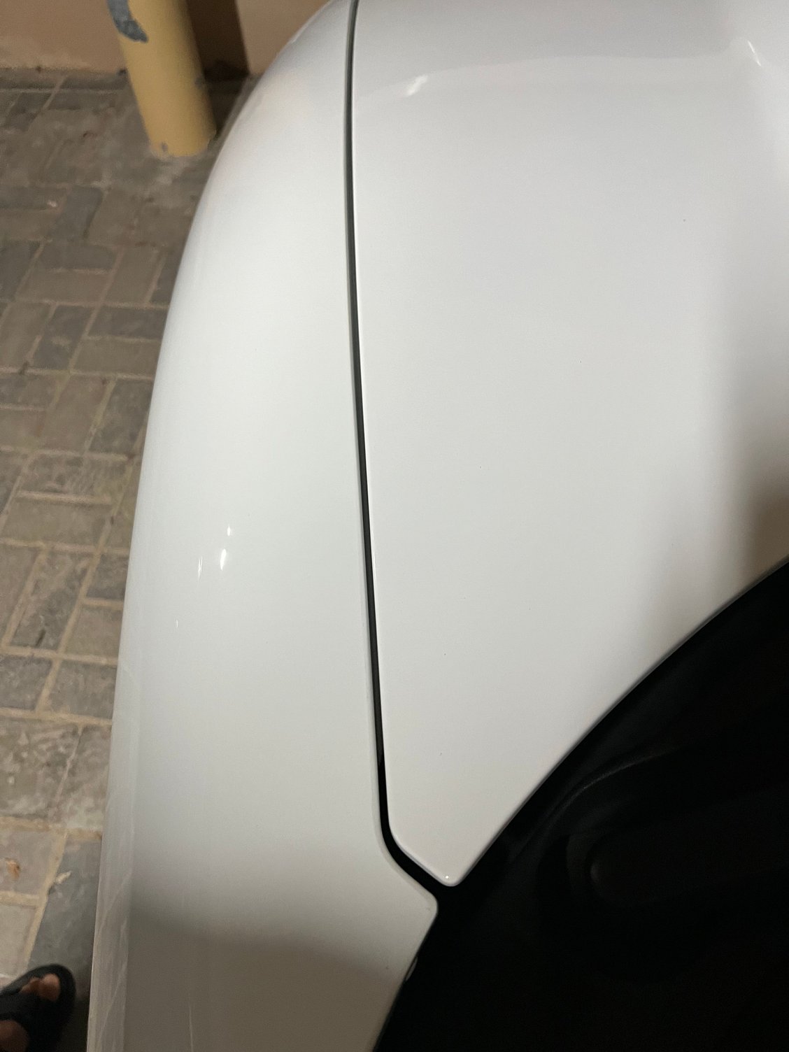

Hello, I noticed that there’s a gap on the driver’s side. I’ll post the pics for reference:
That’s the passenger side, all seems ok.
The gap between the hood, front bumper and the headlight cover is more on the driver’s side.
One of my friends said that this gap can be adjusted with the screw near the headlight but I’m not sure which one, my friend is currently traveling due to his work commitment so I can’t ask him to elaborate further. Does anybody have any experience with this issue?
thanks in advance 👍

Originally Posted by sjsingle1
the headlight cover does have lots of adjustability......is that what you want to move as opposed to the hood or bumper?

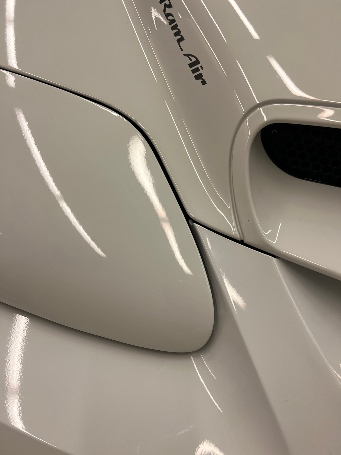

thank you for replying👍 to be honest l, I’m not sure what to adjust. I think even if I adjust the headlight cover (which I don’t know how to do in the first place) there will still be a gap between the hood and the front bumper. Please check the below 👇 pic
maybe it’s a mixture of both, I mean I need to adjust the headlight cover plus the hood maybe? Not sure 🤔
What would you guys recommend?

How is the hood height in relation to the fender top on the driver side? If it's slightly high then you'll want to lower the hood stops. Or you can raise the passenger side slightly. If it's good now then try to ignore it. The car is over 20 years old and there may be some shrinkage of the front bumper. If that's the case not much you can do unless you work every adjustment of the front bodywork. Start doing that and you'll see that gap appear somewhere else.

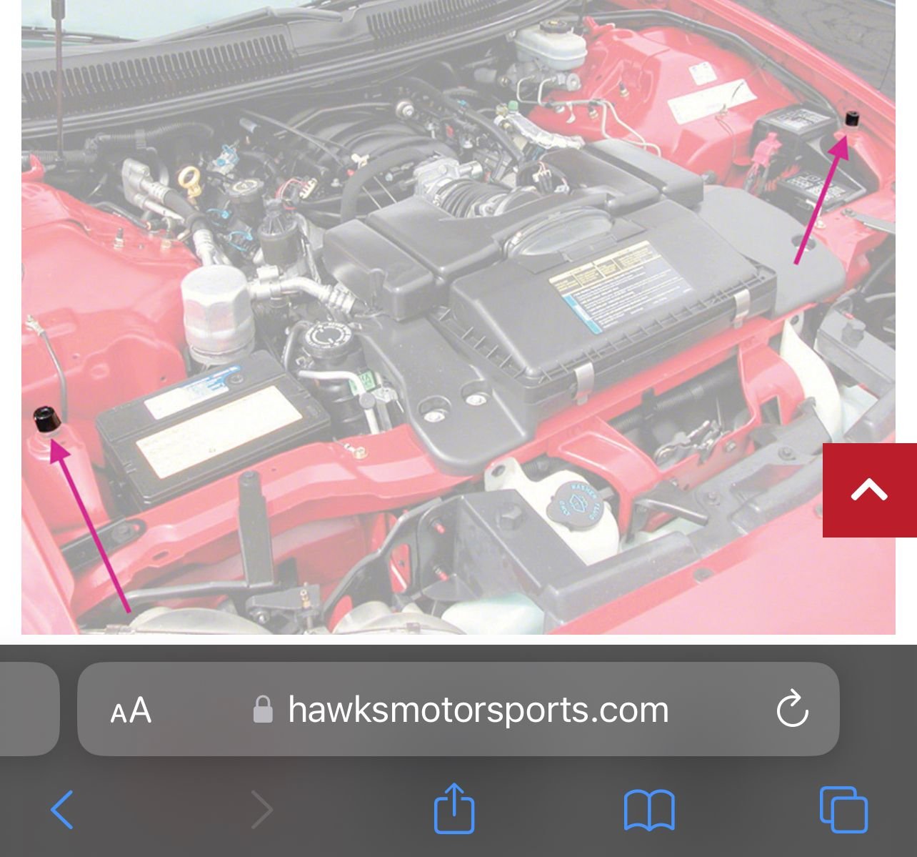

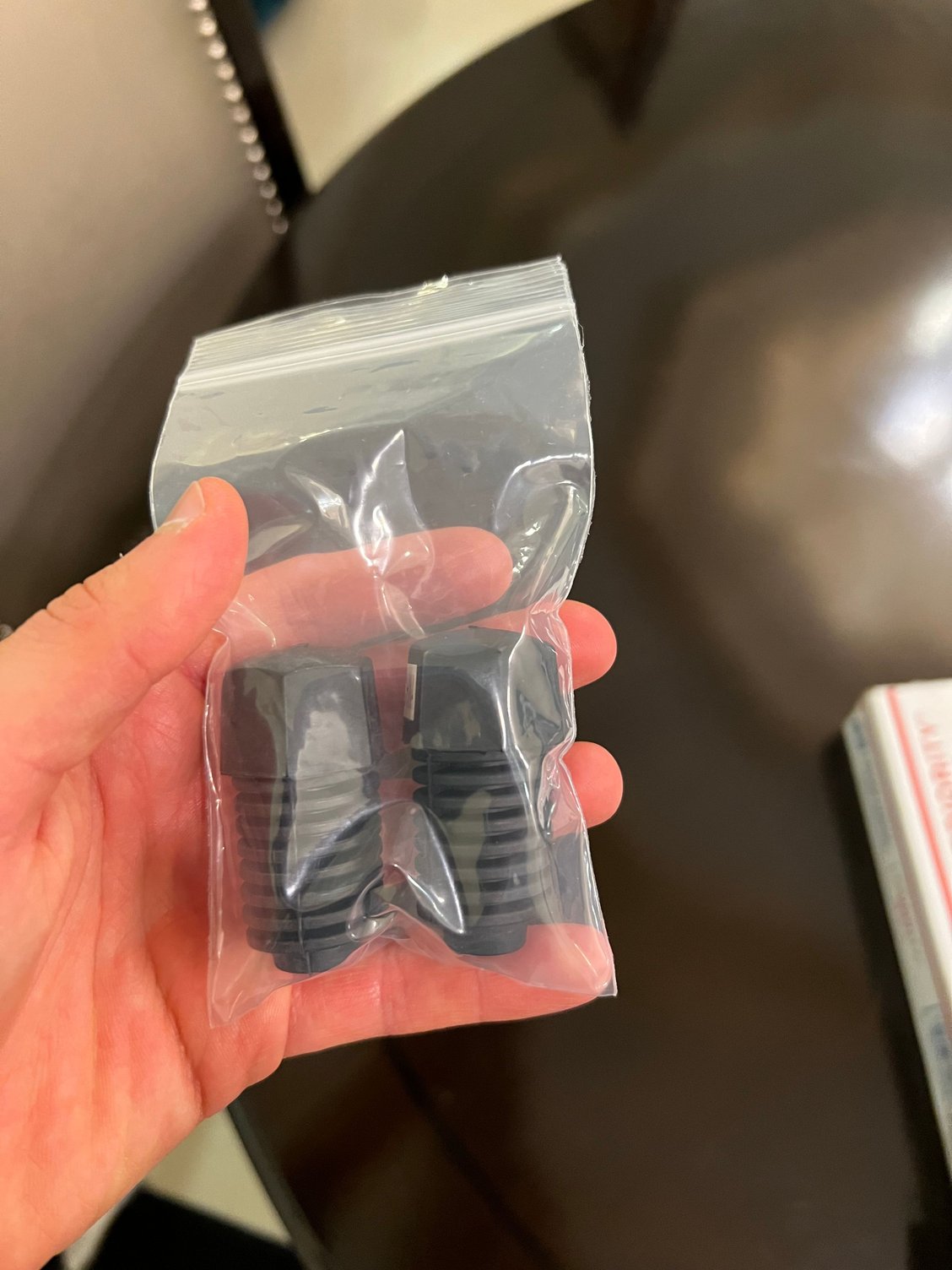

Thank you for replying. Not sure about the hood height in relation to the fender top on the driver side to be honest, but I’ll double check it once I’m back home 👍 I had broken hood bump stops on both sides and I installed new ones from Hawks Motorsport ( same ones you find at the front) they fit perfectly and are stronger than the OEM ones because they are not plastic, they’re rubber. I had the exact same gap before and after the new bumper stops. And I lowered the new ones on both sides as much as possible.
I just had a thought that it could be from the bumper stops on the front, anyway, I’ll double check all of them once I’m back home and keep you guys updated.

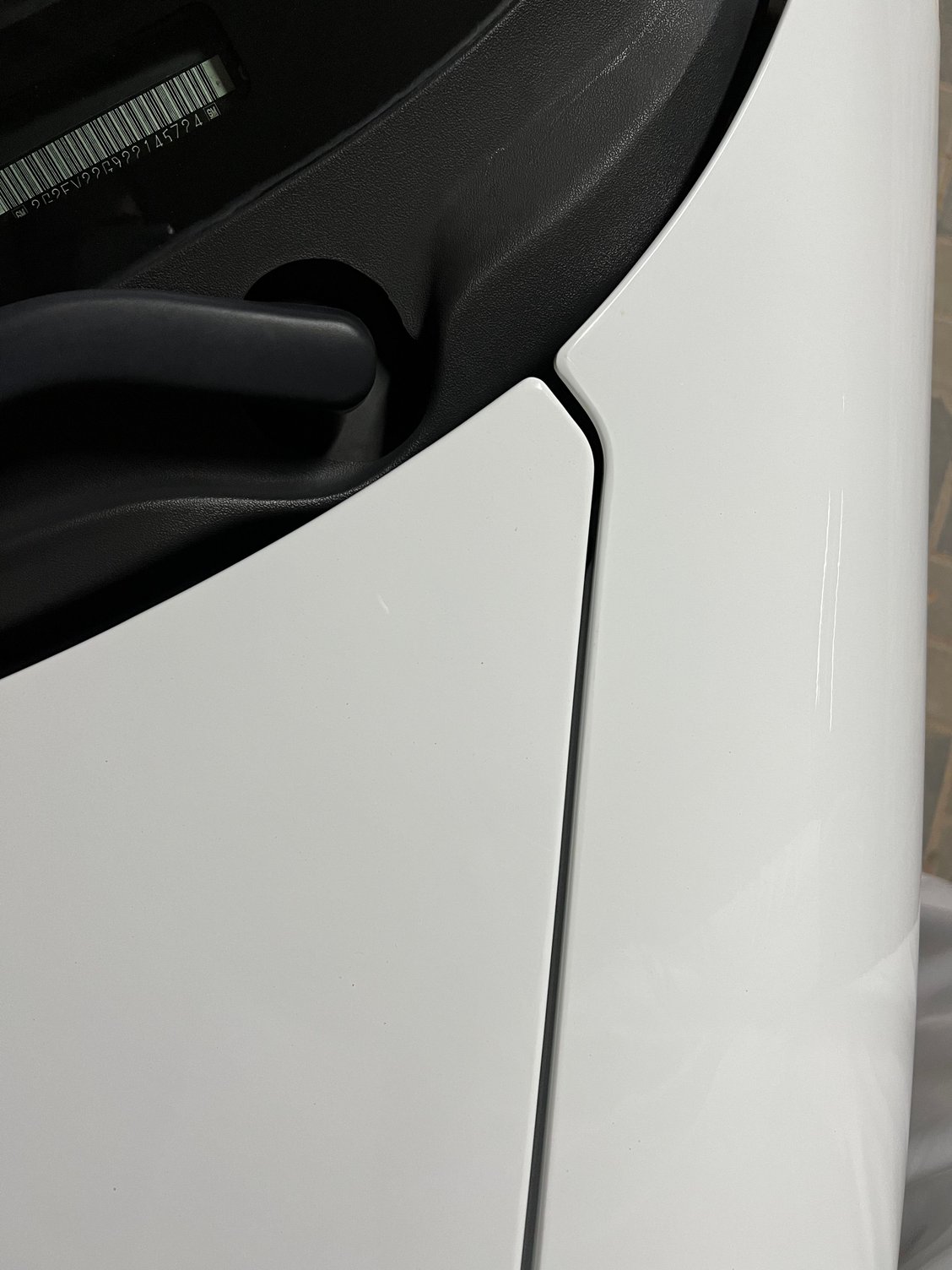

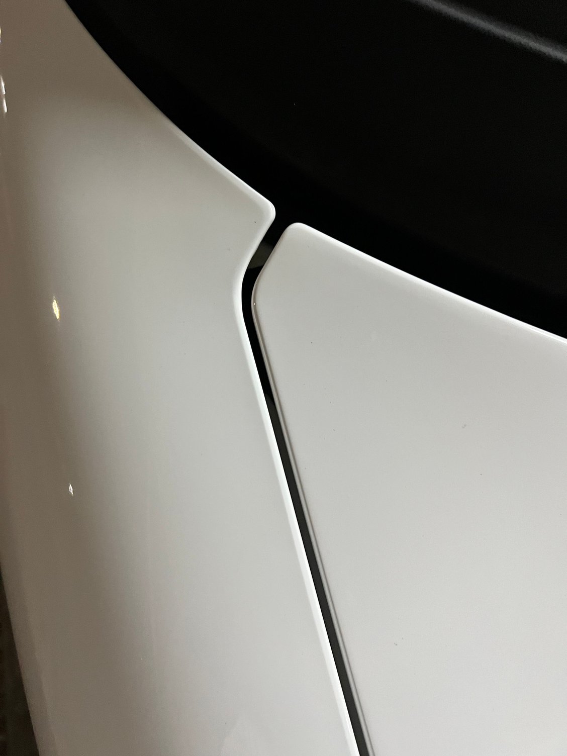

Update: hey guys, I tried to tighten all the hood bump stops (upper &lower) unfortunately it didn’t do anything in my case, I believe it even made the hood latch stuck at one point so I loosened the lower ones just a little bit and the hood latch went back to the way it was. Only the upper ones are tightened all the way now, the gap is still there though.🤷

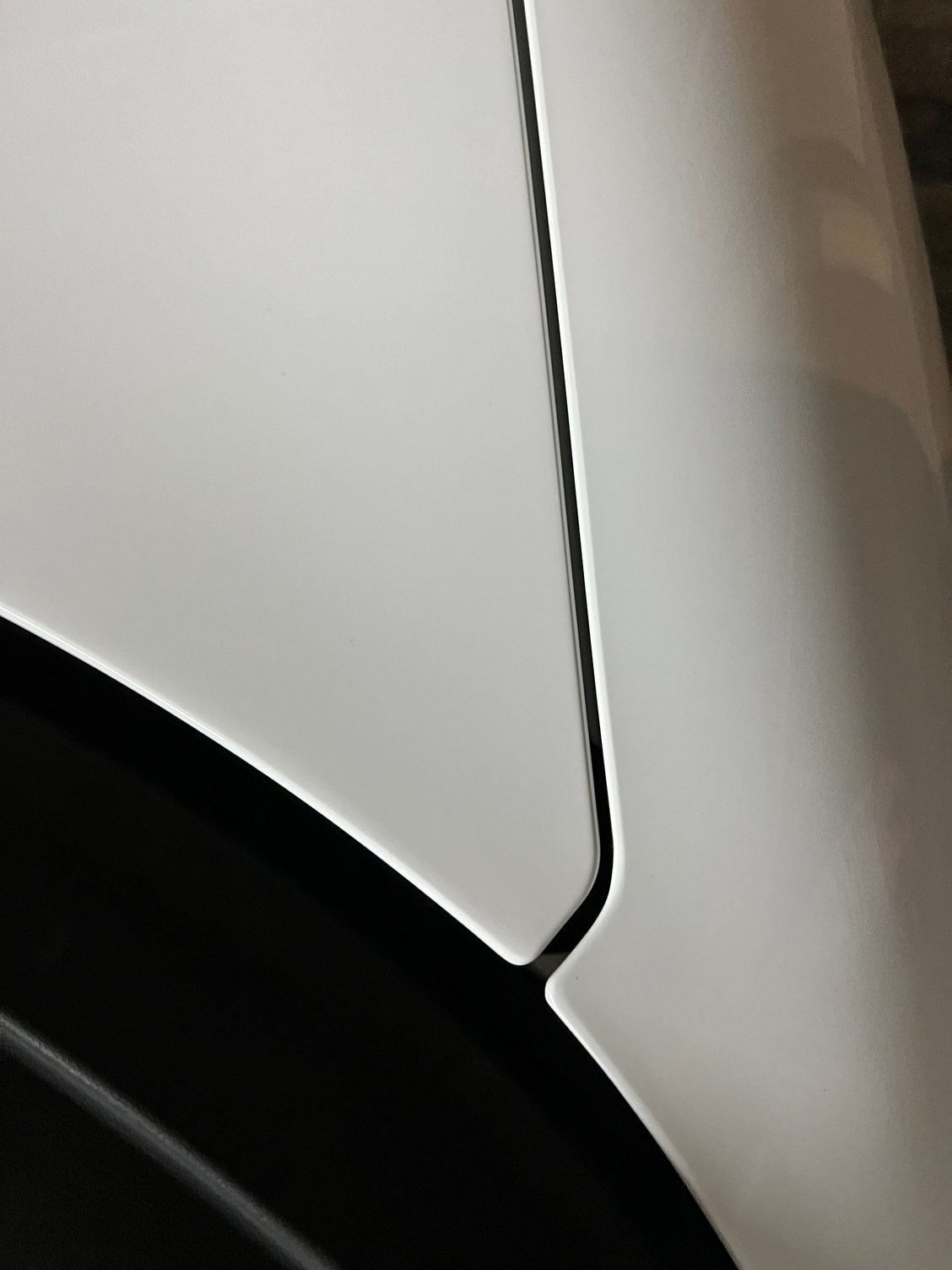

I took some pictures of the hood and how it’s aligned to the fender. I don’t think there’s any difference from the passenger side. So now I’m not sure that the hood is causing the gap. Maybe it’s a mixture of both the headlight cover + front bumper. I’ll let the body shop look at the car while they paint the scratch and the CETA mod.

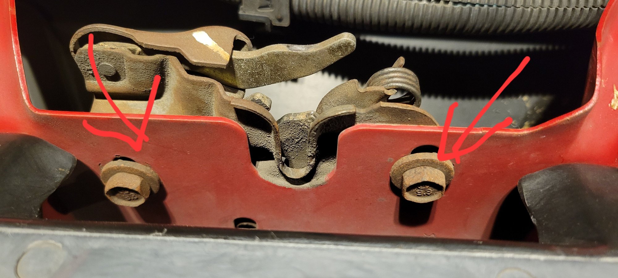

The hood latch is adjustable as well. If it's set too high the hood doesn't contact the stops. That would make you think that adjusting the stops lower has no effect.

regarding the hood latch, if it’s adjustable, how do you adjust it? That’s new info to me. But I don’t know if I should adjust it. Or it may be beneficial in my situation.

Open the hood look down at the latch and you'll see these 2 bolts. Loosen slightly but don't remove and adjust as needed. You can see the slots behind the bolts that give you the adjustment. You will have up and down and some slight side to side. I'm not guaranteeing that's your problem but it's something else to try.
