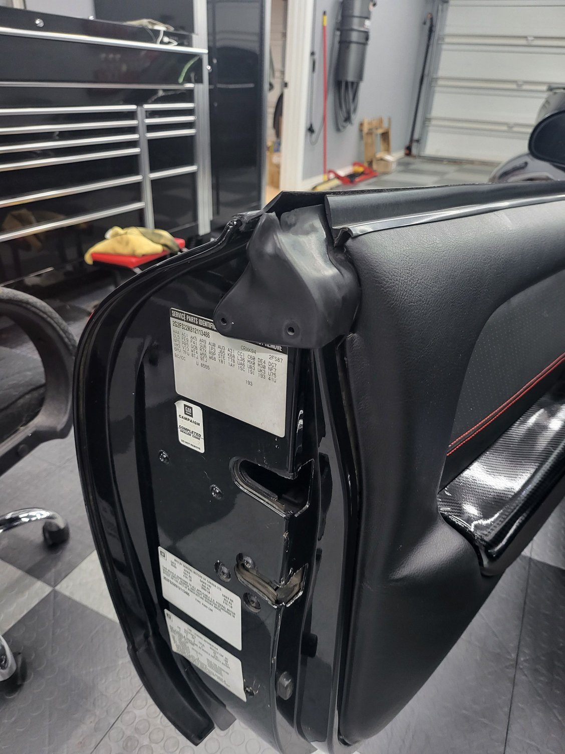

What is this rubber piece at the edge of the window called? I need new pins to hold it in, but can't find any locally.

The rubber piece is called 'seal,FRT S/D RR BELT'.
The pins are push in, GM 8731909, google it.

Thank you! I was searching last night but couldn't word it correctly tk get it to pop up in a search!

got a baggie off amazon, finally resolved
now if I could just find the side skirt clips she'd be all buttoned up again
