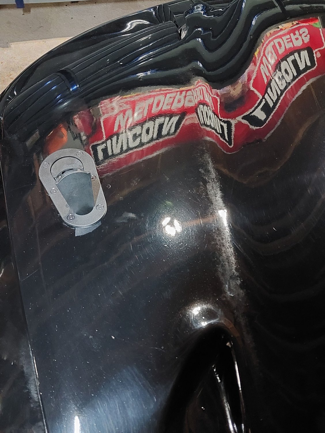

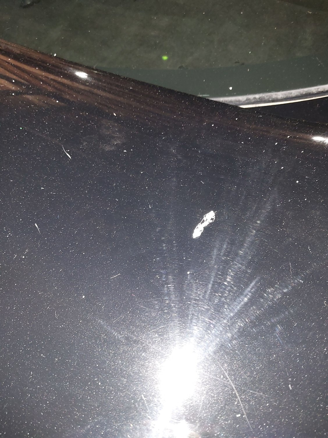

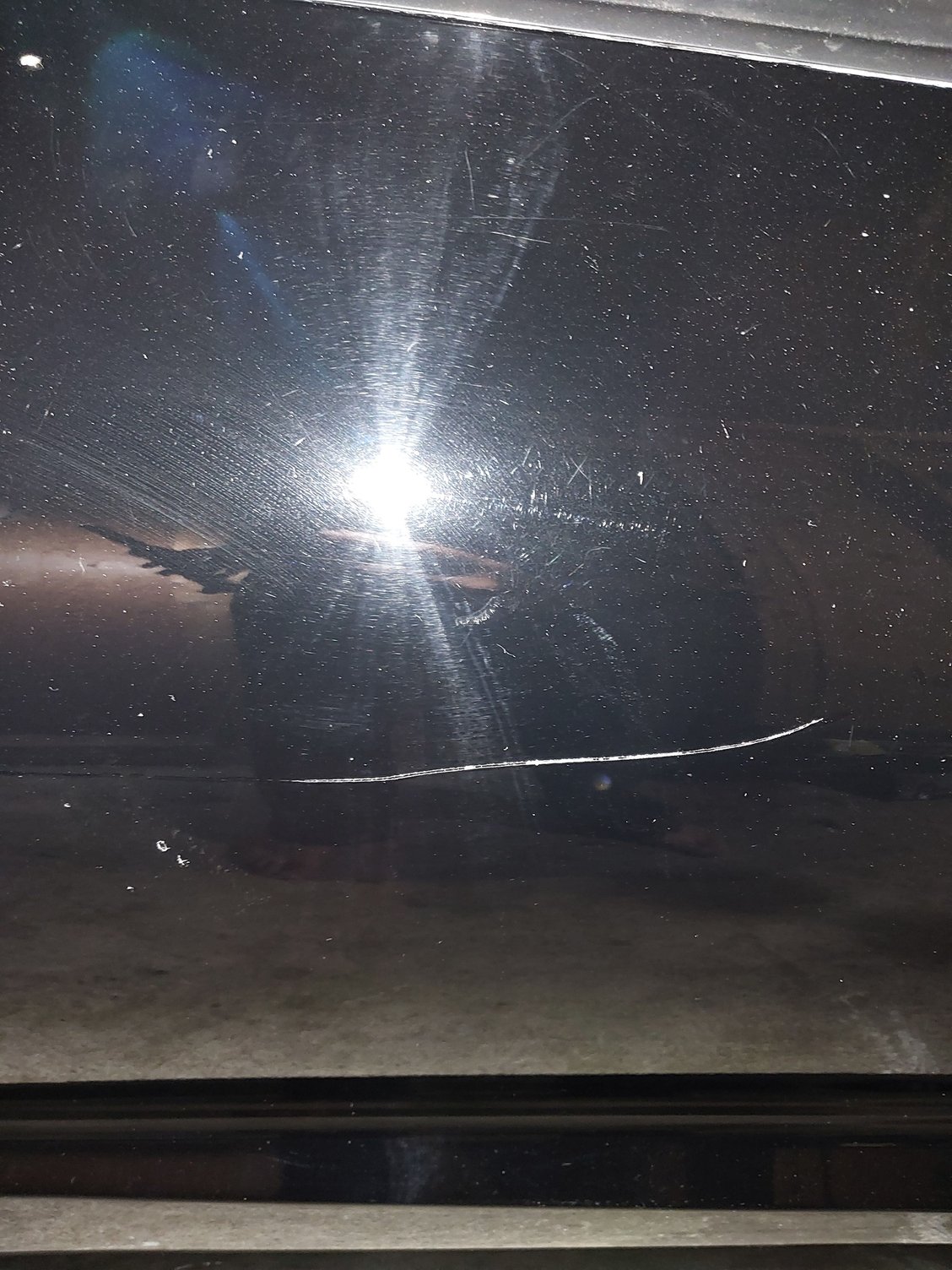

I already compounded and polished the hood and the first Pic was the best I could get it.
The scratches in pics are down to primer and not sure what that hazyness on the hood line is bit wouldn't come out.

looks like oxidation, which usually needs re paint. sand 320, 400, then 600. Then wipe down with wax/grease remover (VERY IMPORTANT). Then use a tac cloth (VERY IMPORTANT). You can use a HVLP gun even with a 28 gallon compressor. I've had great results with SpeedoKote jet black 2k.
keep in mind black can be a bitch to match other body panels. if ur gonna paint TAKE YOUR TIME on the prep. Painting is the easy part. the prep needs to be perfect. use electric sander and sanding blocks.
