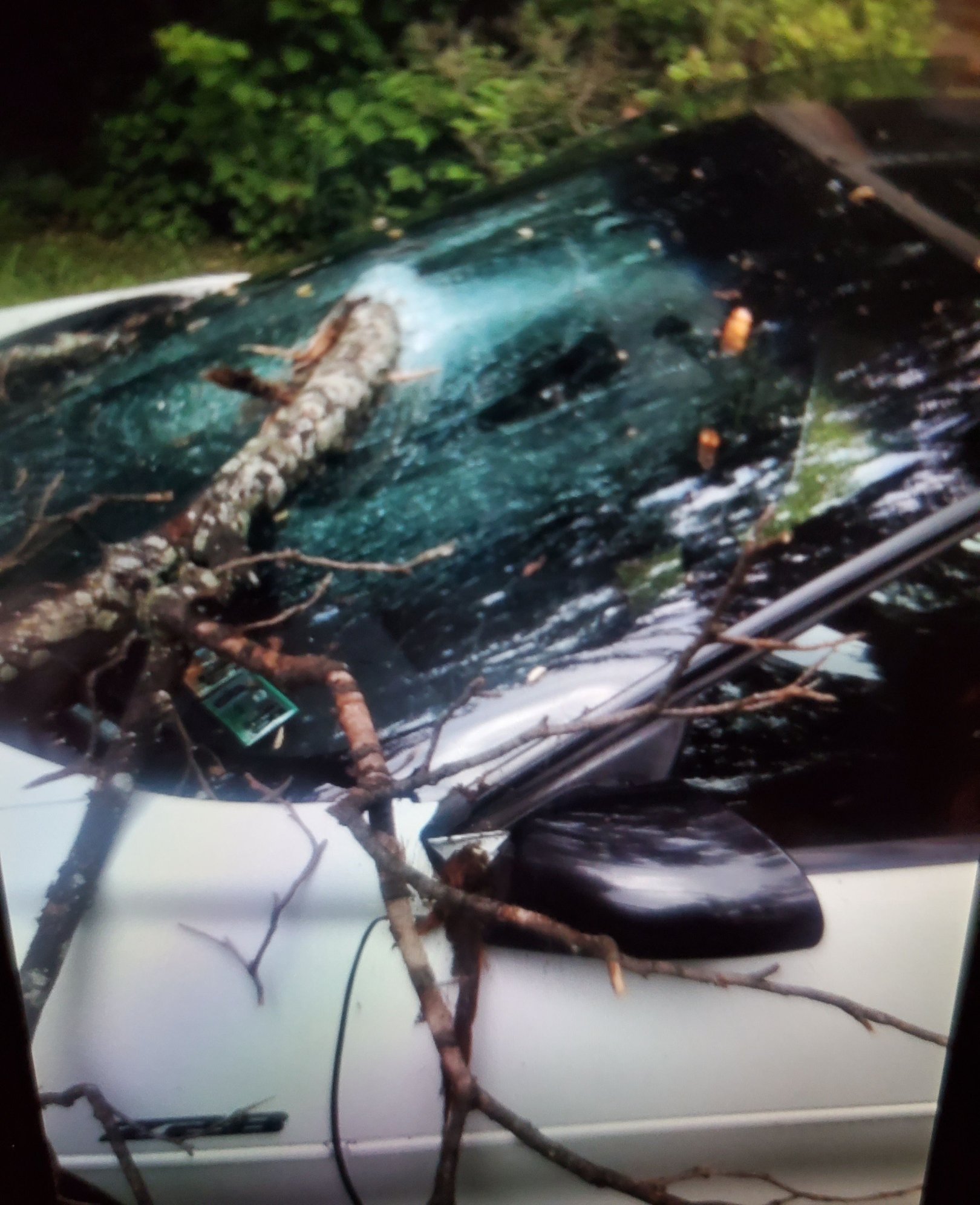

It's a steel hood. The fender might have been replaced at one point. A large tree branch fall on it and broke the windshield and driver's mirror about 10+ years ago in a storm. I dont remember if the fender needed to be changed.
I've had the car about 13 years now (2nd owner). No accidents. Fender fits well except the spot in the picture. I tried to look for adjustments on the hinge, but there aren't any. Ive been slowly restoring the car and really noticed the hood/fender alignment was off. Just looking see if the fender can be aligned better with the hood.

Did some digging. Found an old picture of when the branch decided to impale my windshield 10 years ago. Fender was definitely replaced. With that said, anyway to get the aftermarket one to fit well? Or should I source an OEM one from a junk yard?

The hood wasn't replaced or damaged from the tree?
