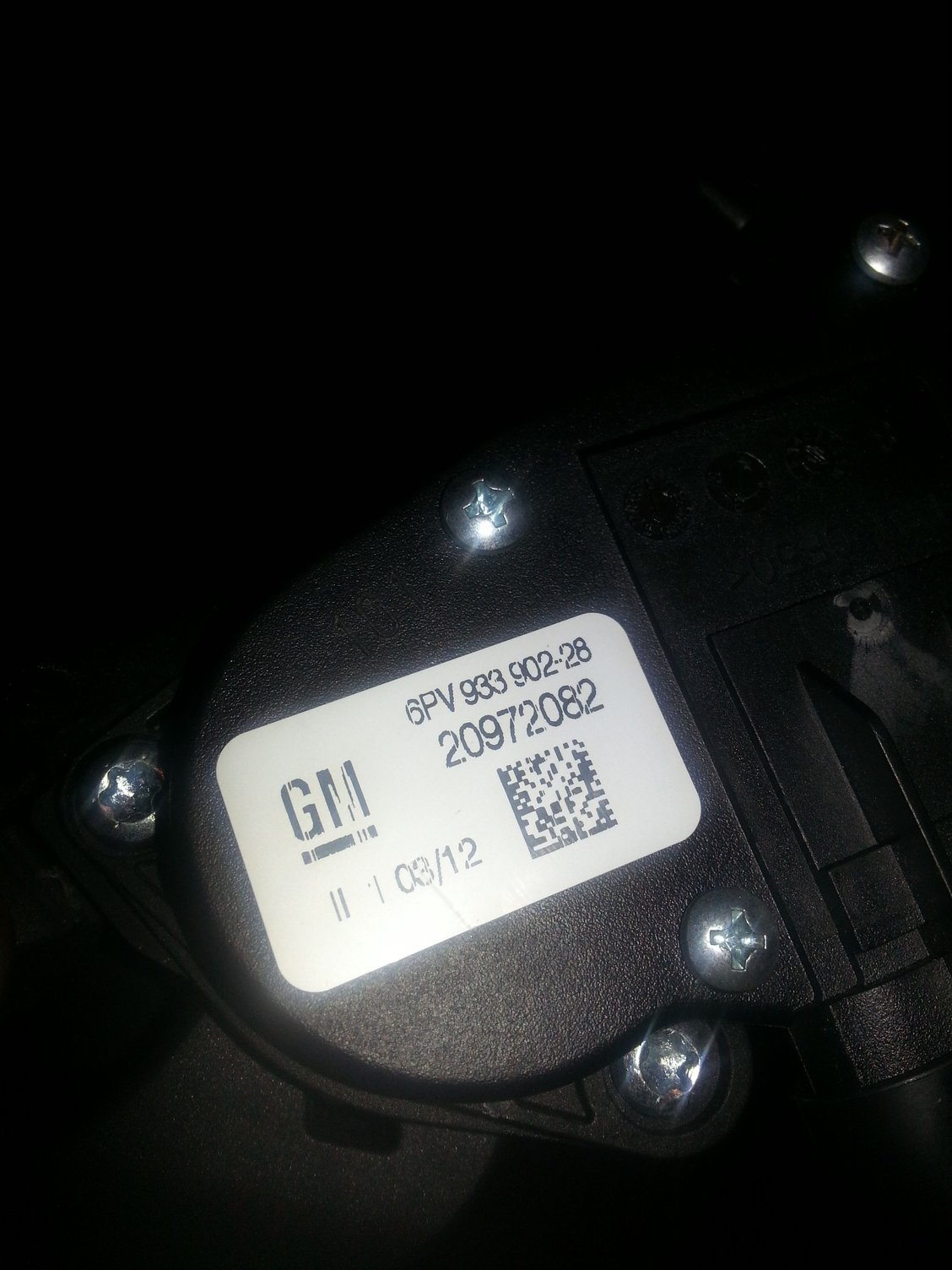

I have the pedal and the small wire harness that plugs into the TAC module.
Now my question (From the gas pedal to the tac module i have)... But where does it goes from the TAC Module ??? I also dont have the pin out information from the tac to lord knows who... so if anyone has it that would be great.

Gas pedal tag

This is what is supposed to plug into the tac module ive seen different wiring pin outs but none match mine ..mines is a 12 wire plug. Off a 2013 silverado

On Gen4 engines the gas pedal goes directly to the ECM, there is no TAC module it's built in the ECM.
The pedal uses a 6-pin connector but it's not part of the engine harness so most of the time it's missing. You need to find one in a junkyard. Then you need to make the wiring for it.
The ECM wires for the pedal are in a big oval connector from the engine harness, you need to splice them there and extend to the pedal.
