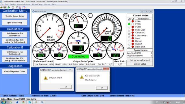

Hello, I have a problem, and the problem with the program setup and calibration, which was on the disk. I already installed on the laptop 4, but the effect is the one I turn the program starts to read the firmware with TKI, at the end of an error run-time error 13 type missmatch. then after you click OK, climbs two more errors and the program closes, version 4.1.2 software worth.
I bought a set of online Jegs.com Chevrolet Performance LS376 / 525HP Connect & Cruise Powertrain System, I have a problem with the program for transmission supermatic, startup gives error 13 type mismatch, as well as error codes 401, 403. Next, the program closes version software 4.1.2, could you throw fresher version and what to do? (Invoice 847445070214)
I tested already on 6 computers. Software is installed 4.1.2. Errors occur when information is read from the controller after connecting with him. Errors such as 13 type mismatch associated with the VBS, ie with the program itself. Please check again.
"Runtime Error '401': Can't show non-modal form when modal form is displayed." and Runtime Erorr '13' type missmatch

Ive used this same software on my windows 7 laptop no issues. When you run it or installed it did did you and do you run it as administrator?
Old Jun 1, 2015 | 08:34 PM
stebasha's Avatar
Joined: May 2015
Posts: 8
I try 6 laptop and some OS Windows XP, 7, 8. no result. Yes run with administrator, maybe who have installer soft ? maybe file .exe is wrong
