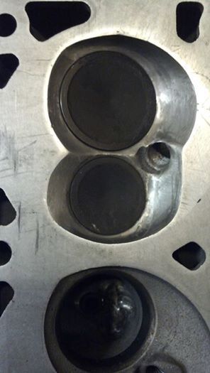

I don't know why I didn't think of just reading the plugs. I would still like to measure cylinder pressure and tune the car on a dyno but in the end, if the ground strap isn't too far down then the chamber and pistons aren't too hot for too long. As soon as I get my welded chamber heads on the 4.8 I'll try this approach on a 175 shot with COS5.
