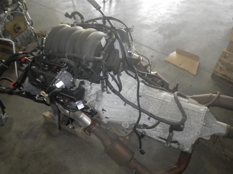

I also want to use the Instrument panel from the same donor vehicle that I get the power-plant, wiring harness and ECM from.
Here is the power-plant I have my eye on buying once I know that we can get it running with no issues..
