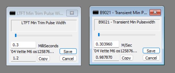

Look for a parameter named "minimum trim pulse width" in the Long Term Fuel Trim section. Stock was 1.2 milliseconds for my car. I divided it by 4 since my injectors are about 4x bigger than stock*, and my car stopped running way richer than the tune called for at startup. I'm not certain that was the key thing, but I think it might have been.
I also changed the open loop target AFR from 13.6 to 14.7, but I was expecting that alone to just raise my AFR from 12:1 to 13.1. It's actually very close to 14.7 now.
* On second thought, they're actually 3.5x bigger than stock. Close enough I guess.

Originally Posted by Kaizen
If I understood correctly, under the Limits section, I found Minimum Injector Pulse Width. This was already set to 0.122 ms in the RPM range of 0-8000.
The AFR is still set to 14.63.
This is a different setting - I don't know where to look for it in HP Tuners, but it EFI Live it's in with some other Long Term Fuel Trim settings.

that table is on the page with all of the other injector information, labeled minimum pulse width, mine was .122 stock also.
There are two tables, with slightly different names. One of them was 1.2ms stock, the other was 0.98ms stock.
This is why I put trim in bold earlier:
