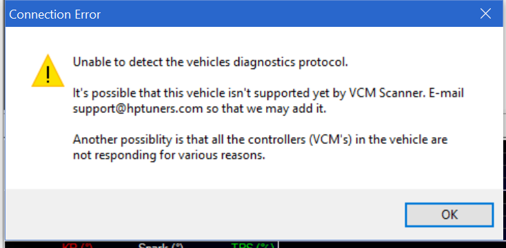

However, when I tried to flash a new tune into the car and was connect first through the scanner the attached error has occurred

Looks to me that the pcm isnt communicating with hpt. But you said you pulled codes with a code reader? To my knowledge if the code reader communicates hpt should too.
1 other thing, make sure the scanner isnt connected while your using the editor. Idk exactly what it will do but id guess pop up no communication. You must stop scanning, disconnect from the vehicle with the button at the top, then go to the editor. If thats fine id try the code reader again and see if it will show you any data.

Quick update, with my handheld diagnosis unit the fuel pump immediately kicked on and I was even able to get the motor to fire.
However, when I still got the same error when I tried to connect with HPtuners.
Could this be a ground issue that is bypassed by a handheld ?

Found a missing ground behind the driver's side head. Fuel pump primes up like it should. Thanks for the help.
